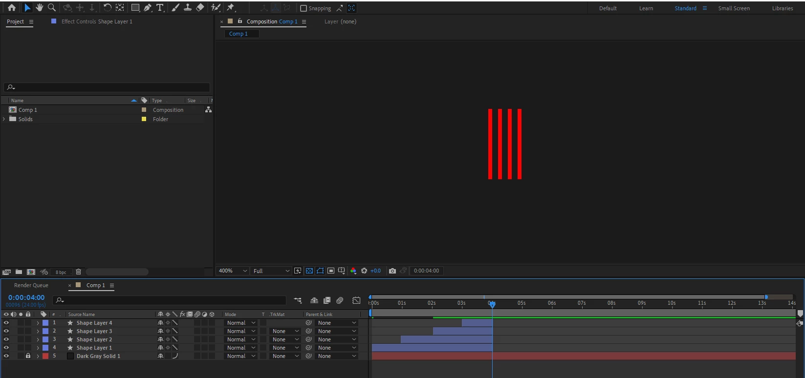

I'm also posting my tedious task, Ive also seek advice from Chat GTP. Make as many bars I need, put them on separate layers, then animate the opacity of the bar 0-100, the keyframes very closely to each other. then spread out the layers on the timeline to achieve one bar reveal at a time, yes it does work, but imagine If I have 100 of them.... So What would be a more swift method, an expression maybe?

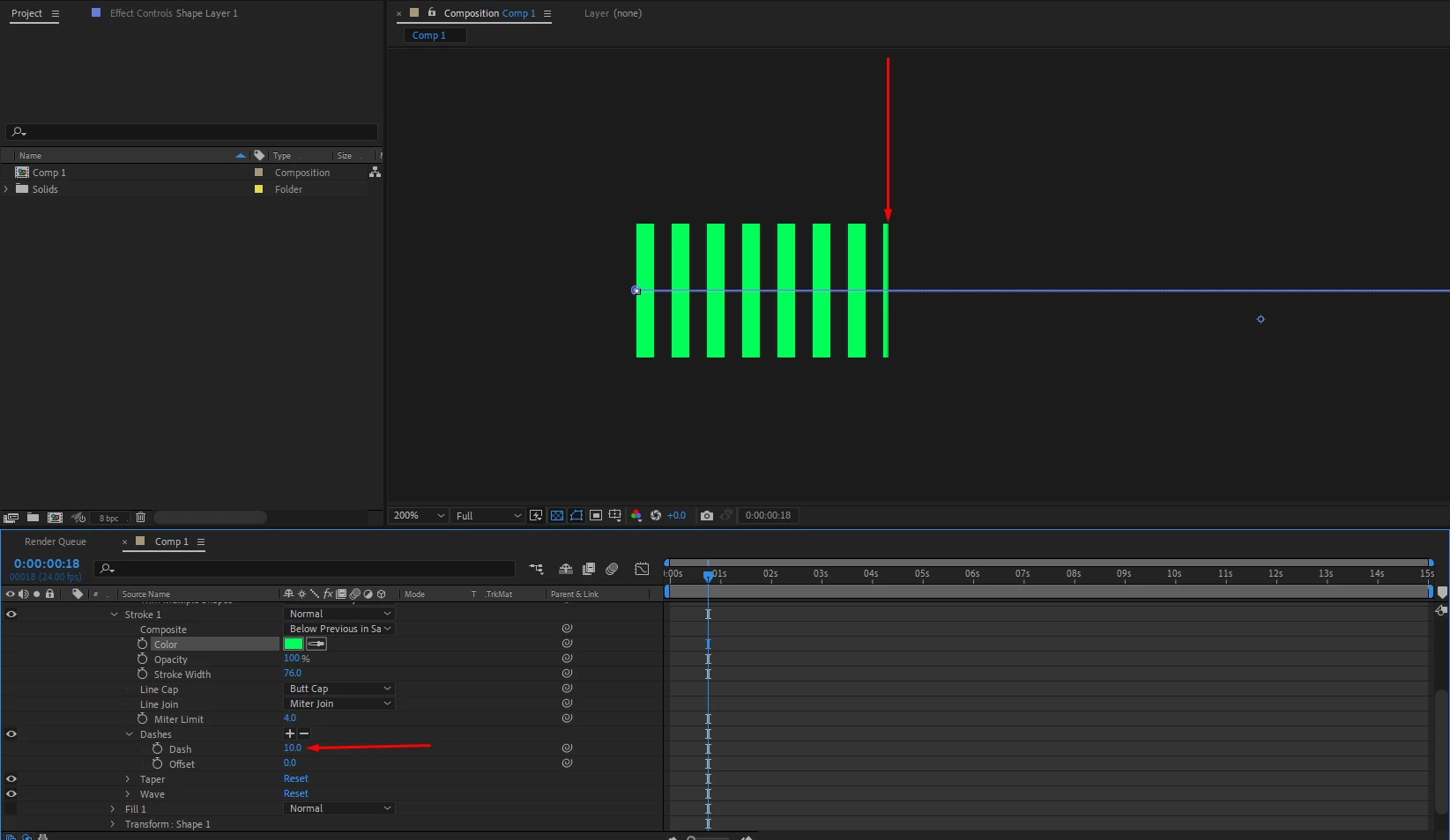

Nov 5, 2025 3:04 AM UTC
Hi Arron.
Thanks for your detailed explanation. I believe I got it, I had to do some minor adjustment, not sure if It was meant to be like this though. when I applied the expression, the bars did appear one at a time, but it did have a little pixel appearing of the next bar line, so I did a minor adjustment of the offset, and it cleared it from appearing.
Now one important factor if it's possible for accuracy. When the bar lines animate one by one, they are not pixel perfect sitting inside the grid. I notice in the dash settings, the minimum is 2, is there a way to get the bar lines sitting within the grid?
Thank you again.
This one hear had a little pixel appearing as the Line bars were animating
https://ibb.co/Cpyj9TgX
This is using 1 pixel grid example:
https://ibb.co/MDr4SCTr
