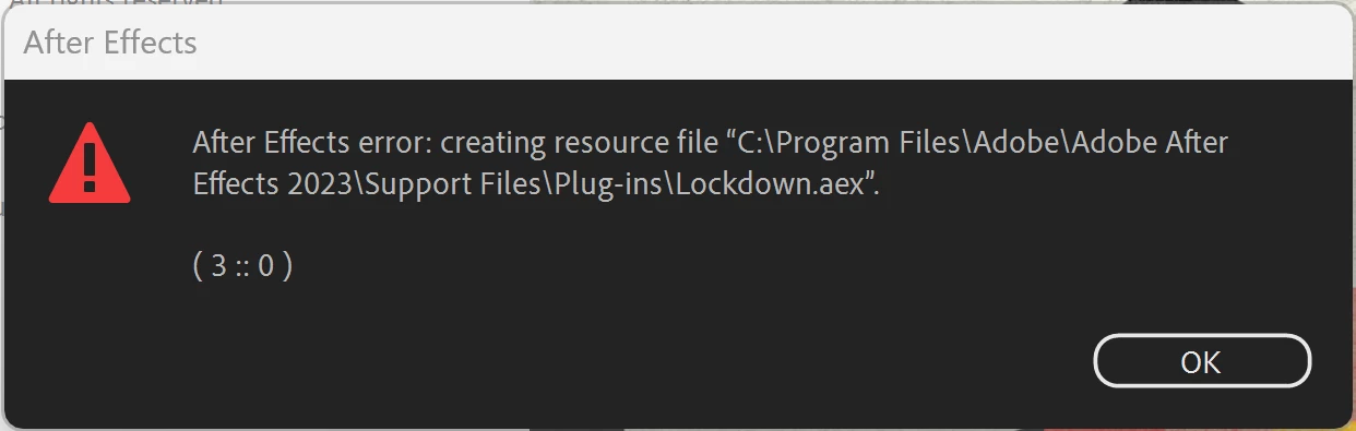

I keep having this bug whenever I open After Effects. It always says this for an example:
So basically it keeps giving me this error, and I contacted support on AEScripts and asked Chris Vranos what is this error for. He first says the following:

I told them that I manually installed a plugin for After Effects instead of using an app. Now, After Effects is showing an error about the missing Metadata Browser. I also tried deleting and re-adding a file called Lockdown but am still getting the same error. I was then seeking advice on what to do next and will update if he found a solution.

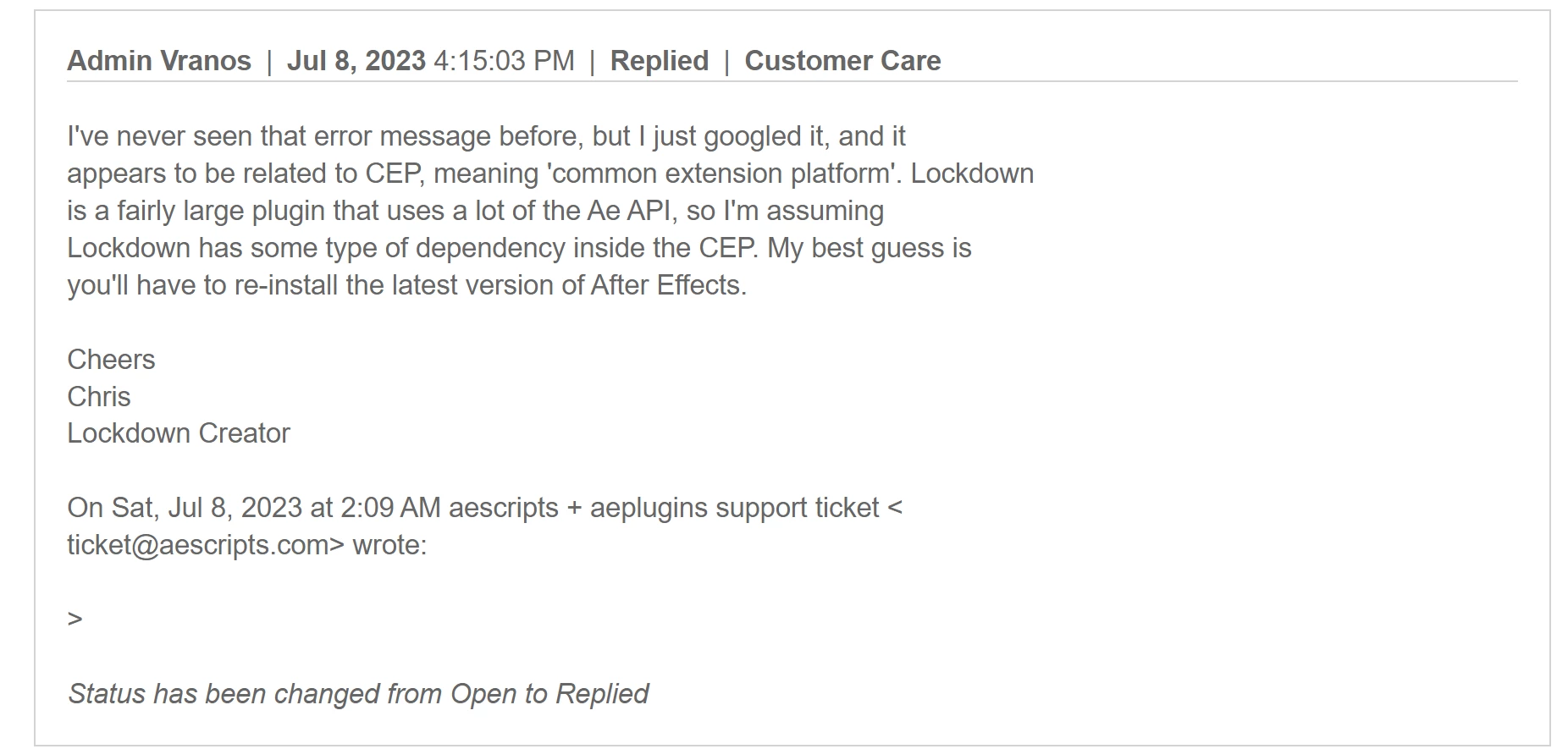

Then he says:
So then I informed him that I already re-installed After Effects and that didn't work unfortunately. Then after that I tried today to see if the reset of the preferences would work and that didn't work either. So I guess my best bet was to post here to try to find a solution to the problem. I hope I can get some updates for this since I have bought Lockdown 2 a while back and now it's not working at all. I could've given him the Lockdown 2 logs but he didn't ask for that yet, so he was thinking it was a problem of After Effects. Not Lockdown 2.
