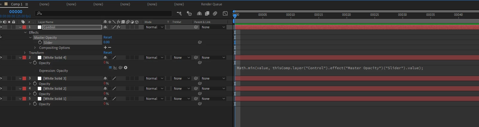

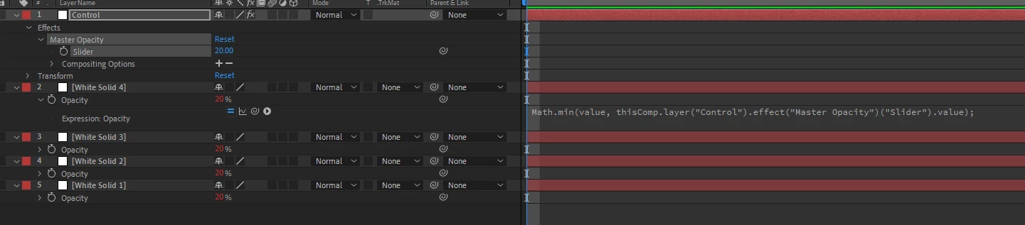

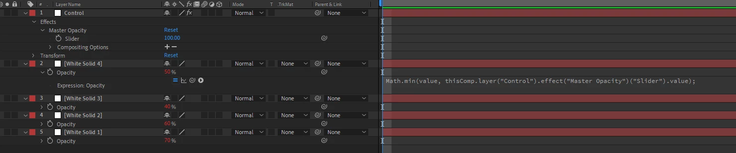

July 16, 2020
Sure, you can set the max limit at your control slider so you can adjust the opacity individually as long as it's under the master control, but once the master control goes down, so does everything else:
Math.min(value, thisComp.layer("Control").effect("Master Opacity")("Slider").value);
