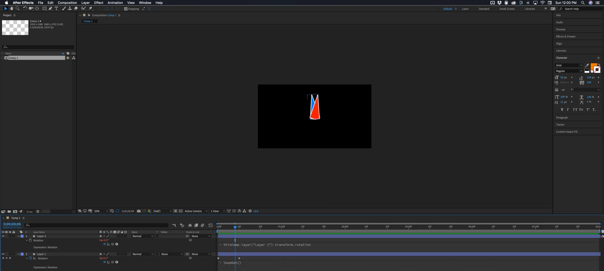

That is still an awfully convoluted way of making the rotation of one layer opposite of the other. No matter how you animate the rotation of layer 1 all you have to do to make layer 2 rotate in the opposite direction is start an expression for rotation on layer 2, type the minus sign then space then drag the pickwhip from layer 2 to layer 1 and you will get this expression:
- thisComp.layer("Layer 1").transform.rotation
Your comp would look like this:
No copying keyframes and no problems.

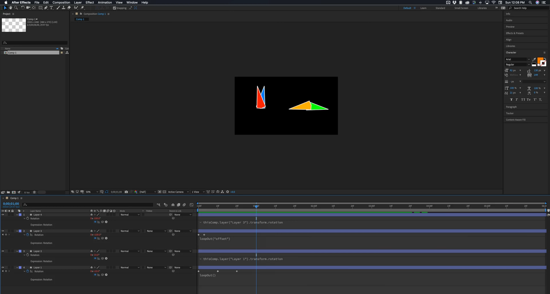

There are also other options for the loop method like loopOut("offset") which would make a layer with only two keyframes continue to rotate. If you leave off the modifier the loop method defaults to "cycle". The only other option is "pingpong"
Here's another example:
One and two are working like scissors, layer 3 and 4 are two pointers rotating in opposite directions.
