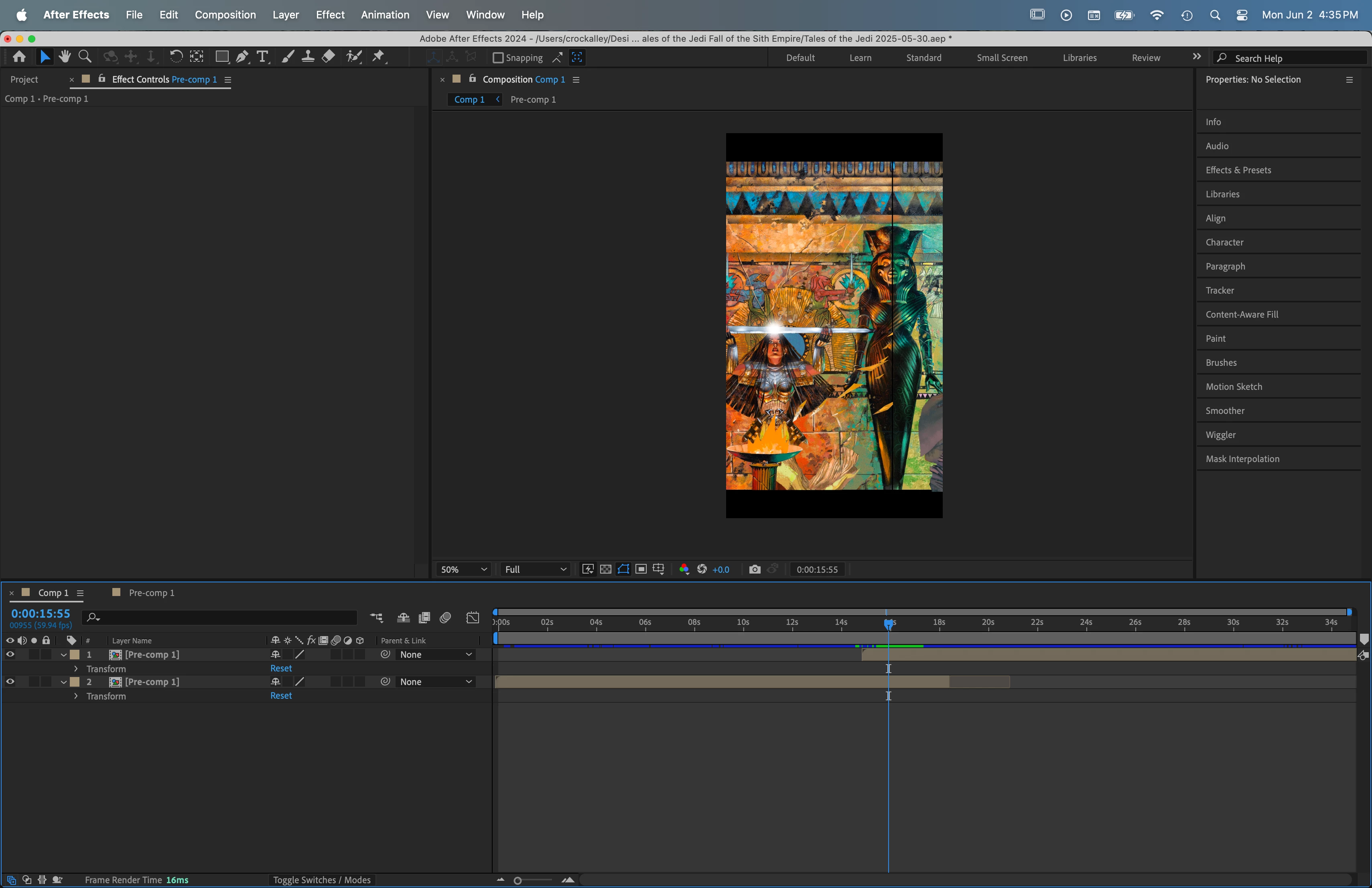

There's a gap of variable size when the end meets the beginning. I can't get the speed just right. See the transition halfway through this video:
https://www.youtube.com/shorts/JEx4mJbBMek
A simple setup. A 3D space, with a wall and a few characters in front. I'm moving the camera from left to right, slowing down at each character. Pre-comose the whole thing, then putting one copy next to the other.
I'm fairly amateur at AE and I'm grateful for any help.

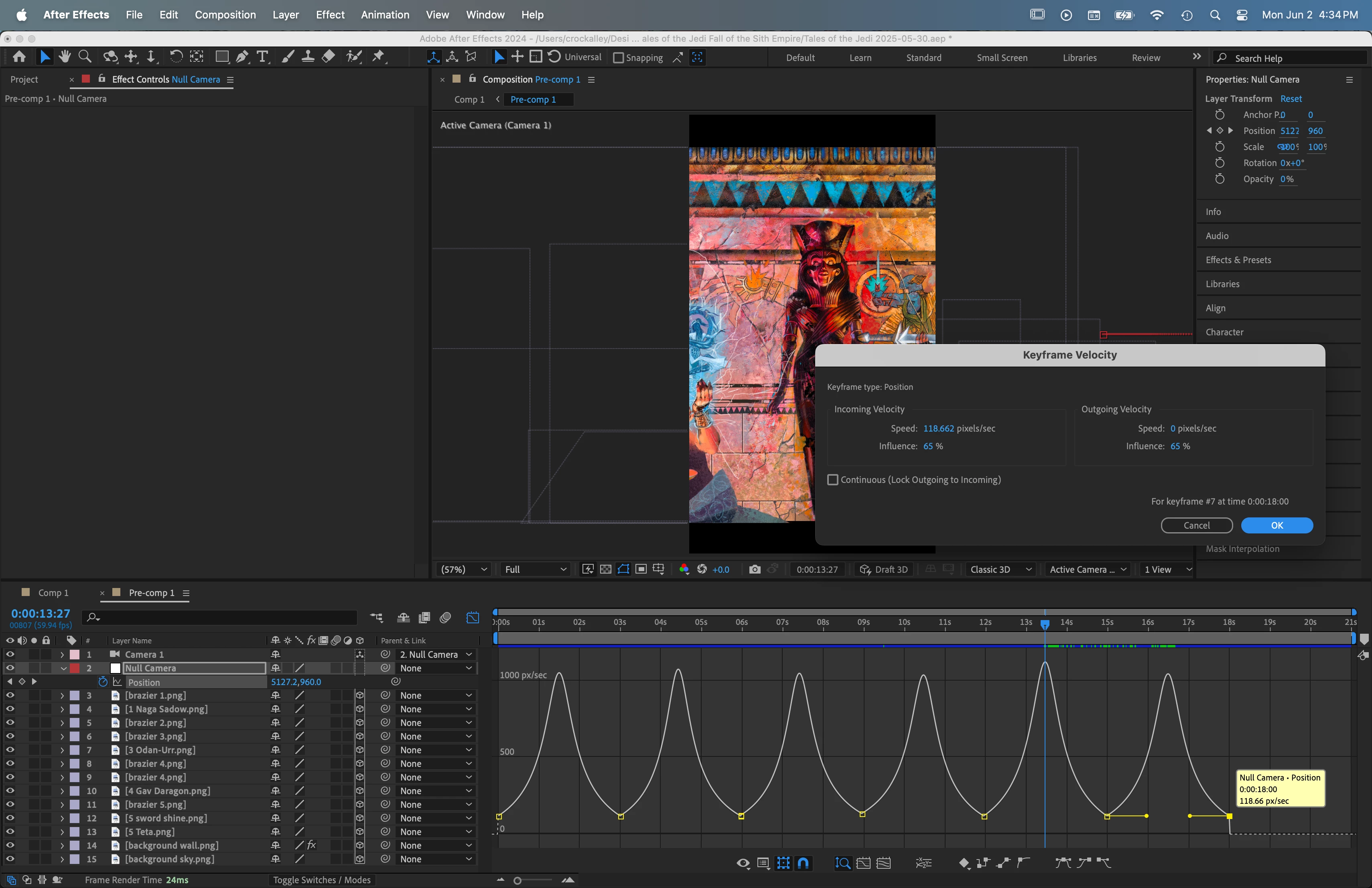

Have you tried matching the velocity of the other keyframes? Sorry for the frustration.

Jun 3, 2025 1:46 AM UTC
Thanks for the suggestion. I've gone through and made all the keyframes have the same speed and influence, but the gap remeains. (It starts as a gap, then closes, then openes again as it crossed the screen.)
