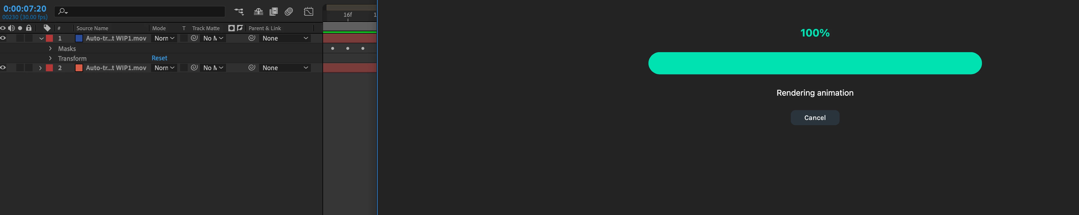

Hello there,
 I was wondering if anyone had any advice or input at getting an animation completed by the extension Lottiefiles.
I am working from a mov file that I have auto traced.
There are no effects being used and there are no track mattes. Simply two auto traced layers with fills. Something I would have thought wouldn't have been too complex and quite easy for Lottie to render.
However, my render is stuck at 100%, I'm at a slight loss at what more I can do in order to get this animation across the line.
If you have any input or guidance I would greatly appreciate the support.

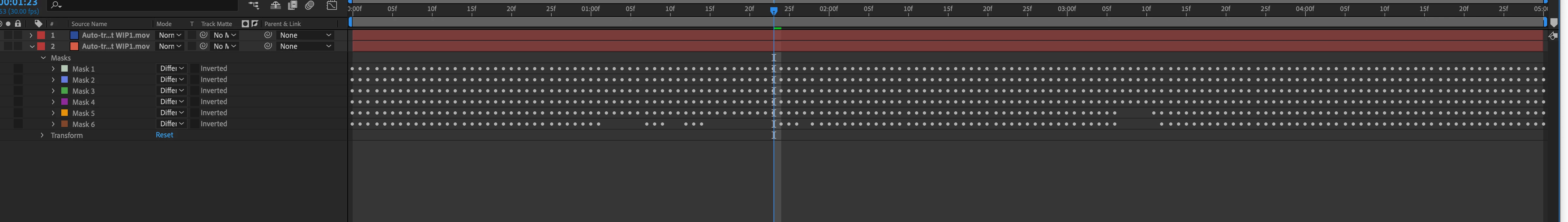

If you want to render a vector animation, you need to move those masks to solid layers or convert them to shape paths and get rid of the MOVs. It looks like you're still trying to render video from your timeline.
March 31, 2023
Awesome thanks for the feedback.
There are no MOV's in this file anymore. Apologies, it's an auto traced layer I should have renamed before posting.
How do I convert the masks into a shape?
March 31, 2023
Ah, thanks for that second screenshot. First, as an FYI, lots of keyframes could make for poor performance, but in this case, I think the issue is the Difference blend mode on the masks. Here's a list of all supported features in Lottie and you'll see that only Add and Subtract are supported on all platforms. So unfortunately, moving these masks to a Shape Layer won't help. https://github.com/airbnb/lottie/blob/master/supported-features.md
Is it possible to preserve the animation by deleting some masks and using only Add and Subtract blend modes? That might be a tall order, but short of doing that or recreating the animation, I don't have any other suggestions without seeing what you're actually working on.
