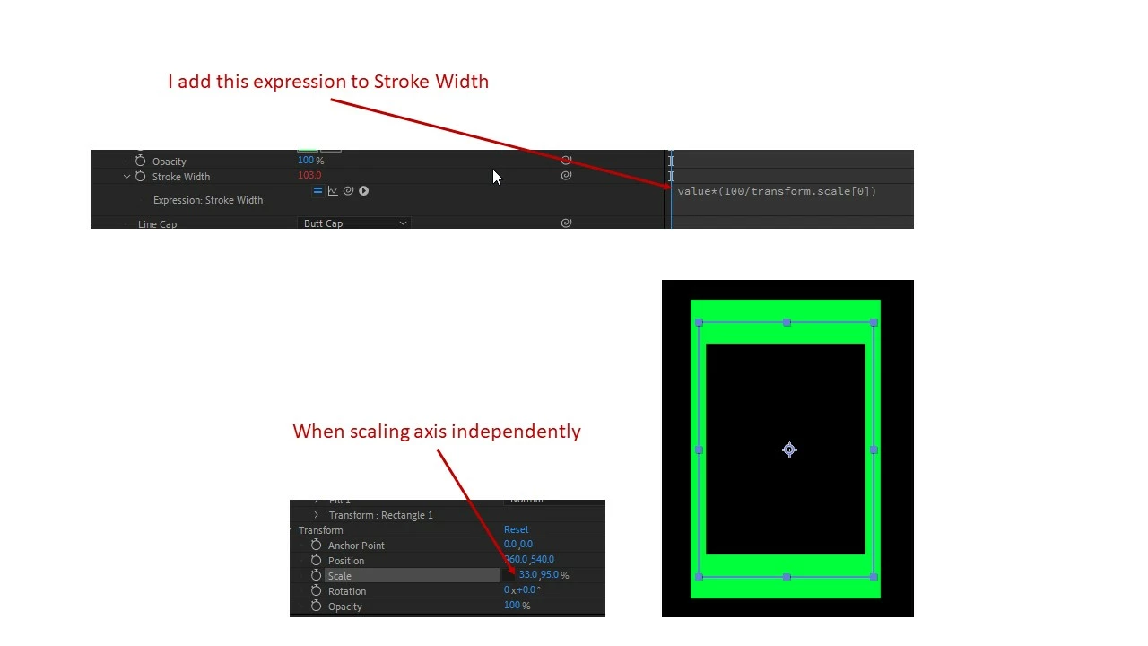

Maintain Stroke Width When Scaling
Hi. I'm trying to maintain stroke width when scaling a shape, and I use the expression below (added to the "Stroke Width" property). It works when scaling with both axis constrained. However, if I scale the axis separately, the expression doesn't work anymore. Is there something I can add to it so that the stroke thickness remains the same when scaling them independently?
value*(100/transform.scale[0])
Thanks

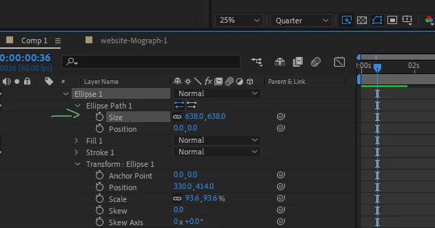

Sep 5, 2024 6:32 AM UTC
Under path, change "Size"

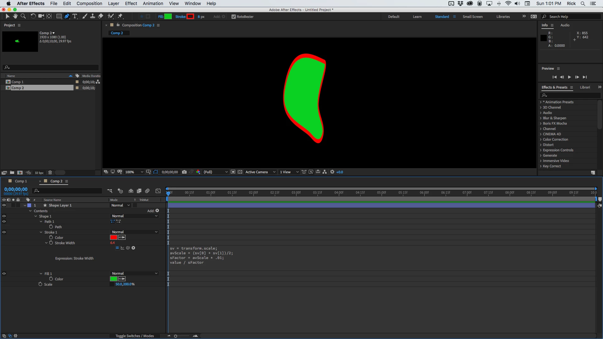

Oct 25, 2020 8:02 PM UTC

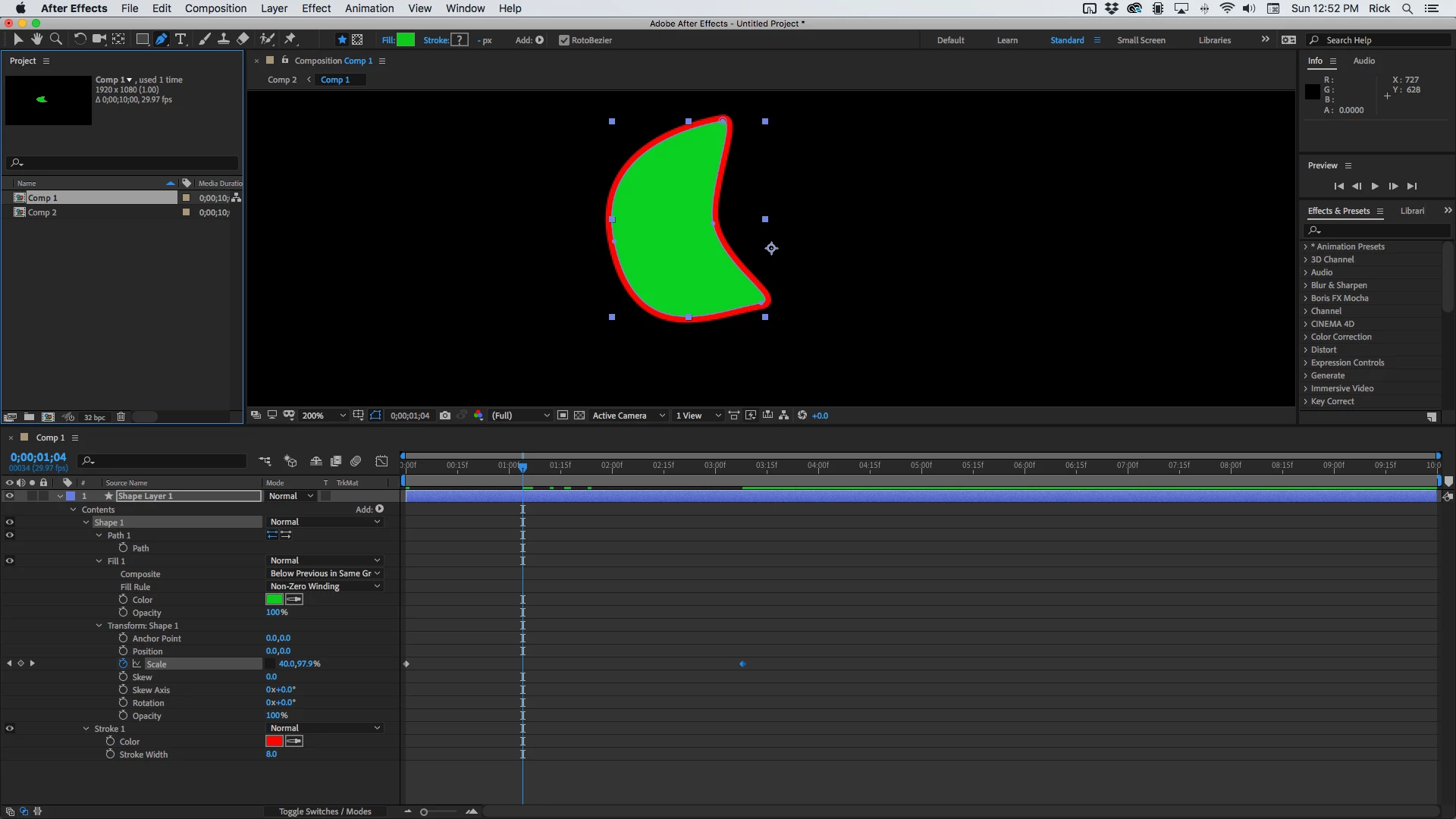

The easiest way to maintain a stroke width when scaling a shape layer is to move the stroke below Transform Shape and then use the Transform Shape/Scale instead of layer scale.
You can't maintain a constant stroke width if you scale the layer using different X and Y values because there is no way to know which part of the stroke needs to be adjusted or tapered. The best you could do is average the scale values and divide the original stroke width by the scale factor like this:
sv = transform.scale;
avScale = (sv[0] + sv[1])/2;
sFactor = avScale * .01;
value / sFactor
That will give you this when the X scale value is 50 and the Y is 100:
Changing only the Y scale value will maintain the thickness of the vertical part of the stroke, but the horizontal part of the stroke is going to change with the layer scale.
