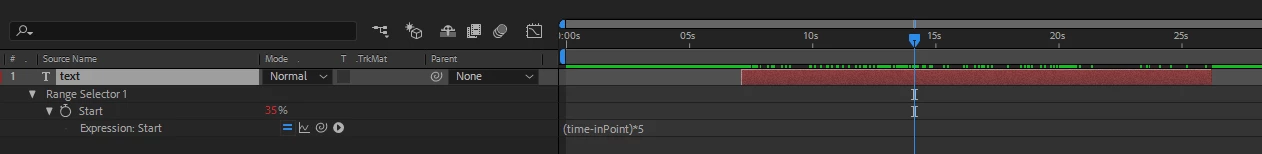

    I have another question. Using the settings you have provided (which do work and it's all going well, so thanks)...
    So my scene comes up and there a picture in the background. Now, as things stand the Typewriter FX immediately starts doing it's thing - but how do I get it to hold off for, say, two or three seconds, before beginning to type away? I have looked everywhere, tried every obvious thing, but nothing works.
    Is there a way to delay the start of the Typewriter FX until I want it to start? Is it some button/switch/setting/expression...I'm at my wit's end.
    Sorry for being such a hopeless n00b! Any help again gratefully received!
    you don't have to use expressions BTW. you can simply set a first keyframe of 0 on the "start" parameter. set another far away in time at a high value (see that you like the speed) and then simply move the layer in time or the keyframes to make it start at another point in time.
    if you do want to expression to take into account the start in time of the layer (where it starts in time) then change it to:
    (time-inPoint)*5

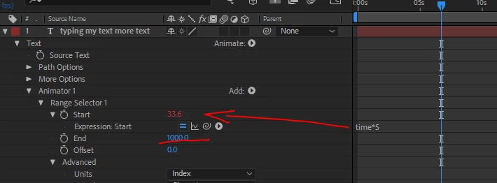

    Thanks, I'd seen that reply earlier, but I don't think it answers my central question: I want to set the Typewriter FX to 'type' at a slower speed by default. This means whenever I use it it will always type at that speed.
    Perhaps the use of 'Index' in the reply above does that, but I don't see it when I try using it. Type still comes flying out at the default speed of the FX.
    I just want one, universal, realistic typing speed from the FX whenever I use it, but slower (at least by half) than the default speed than it is currently set to.
    Roei Tzoref
    November 20, 2017
    change the units to index - now it will type at constant speed that is depended upon characters and not percentage. this means that if you set the "start" parameter second keyframe at a large number and move it away, and set the "end" parameter a large number of characters so it won't reach the end - your speed will remain the same for any sentence.
    you can use an expression to save the need for keyframes:
    time*5 (5 means it will advance 5 characters each second)
    set the end parameter to big large enough (say a 1000 or even 5000)
    save it as a preset and there you go - you got a preset that gives you constant speed no matter what you type.
    BTW, I am not sure this mimics the way a user types. variable speed typing is usually the case if you wan't to be realistic about it since we are not machines that type at the exact same pace all the time.
