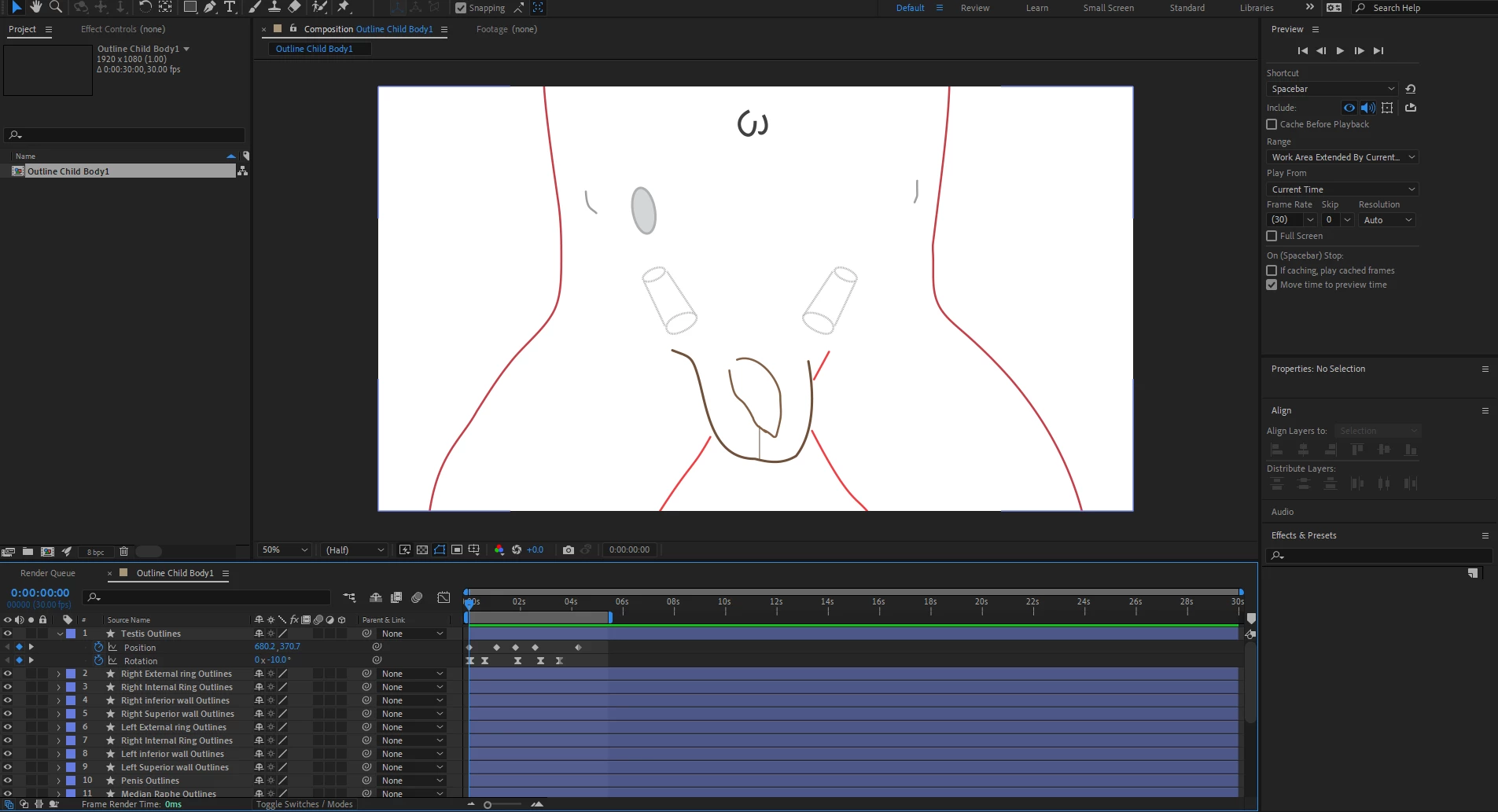

Hi, I have an oval ball that I have animated to move from point A to point B along a curvilinear path. The anchor point is at the bottom of the oval.
This ball has a string attached to the top. As the ball moves, I would like the string to move along (touching the top) with the ball, and the extended string should take on the shape of the path along which it is being pulled by the ball while remaining stationary at the top.

You can use a shape layer path as a motion path and add Trim Paths to the shape layer Path to get it to follow the ball. It may take a few keyframes.
You can also attach nulls to a path with the Create Nulls from Paths script available in the window menu, then shift + parent a null to the ball. This will make one end of the path stick to the ball no matter where it moves.
If you can show us a screenshot by dragging it to the reply field instead of using the "Drag & drop here..." area that shows your entire UI with the path showing, and the animated properties of the layers, we can point you to an efficient workflow.

As you can see, I am a beginner. I am doing this project for my medical practice. The oval represents the testis that comes to the bottom of the scrotum. The testis has blood vessels (the string) that must follow the testis down and be visible along the entire path.
nathanirAuthor
Mar 2, 2024 6:01 PM UTC
I haven't drawn the strings yet. I was trying to conceptualize what I would do to get it to work.
