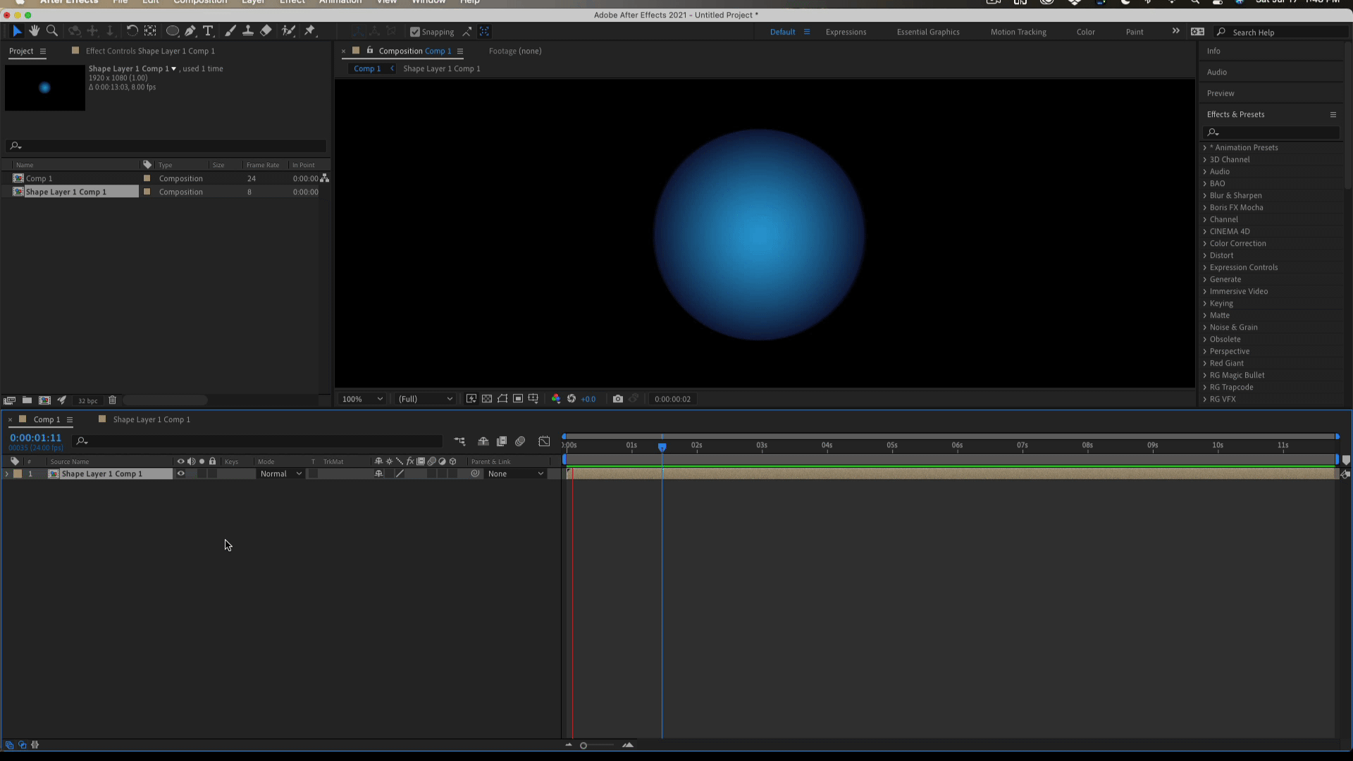

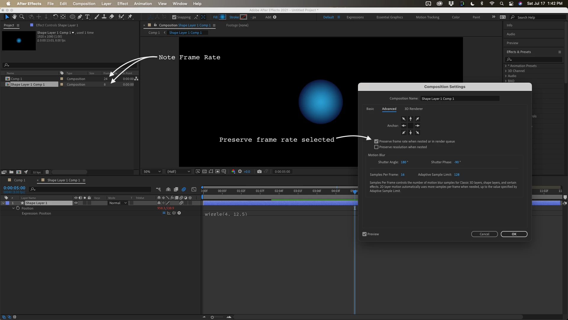

If the motion is random, it is highly unlikely that you would notice the 2.5-pixel difference between X and Y so just positioning the layer at 960, 545, and adding wiggle(4, 12.5) would give you a jitter that is close to the right range. If you want to make the movements sharper Pre-compose the layer moving all attributes, open the Composition settings of the new comp and change the frame rate to 6fps, click on the advanced tab, and set the comp to preserve frame rate when nested.
You will get something like this:
That's the simplest way I know of.
If you want the precise range for X and Y, separate dimensions. There is no need to monkey with time at all unless you want random sections with no movement.
