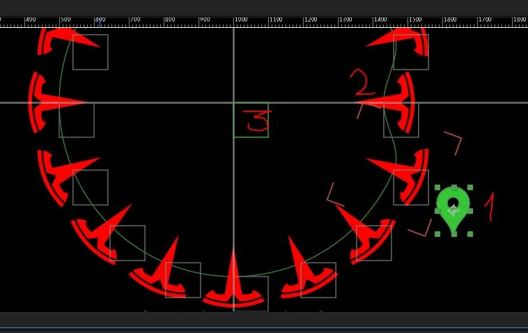

Dear Community, I have the following problem/goal:
When object #1 gets closer to object #2, the distance between #2 and #3 must be reduced. (Object #3 should, however, always retain its position)
The following solution is not satisfying, because although the position is manipulated, the movement is not always oriented to the center (where object number 3 is located):
var p1 = thisLayer.position;
var p2 = thisComp.layer("Effector").position;
var delta = sub(p1,p2);
var distance = length(delta);
linear(distance, 0, 250, [value[0],value[1]+100], [value[0],value[1]]);
Thank you in advance for your expertise.

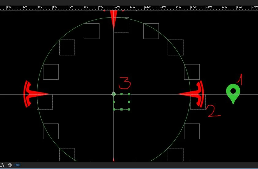

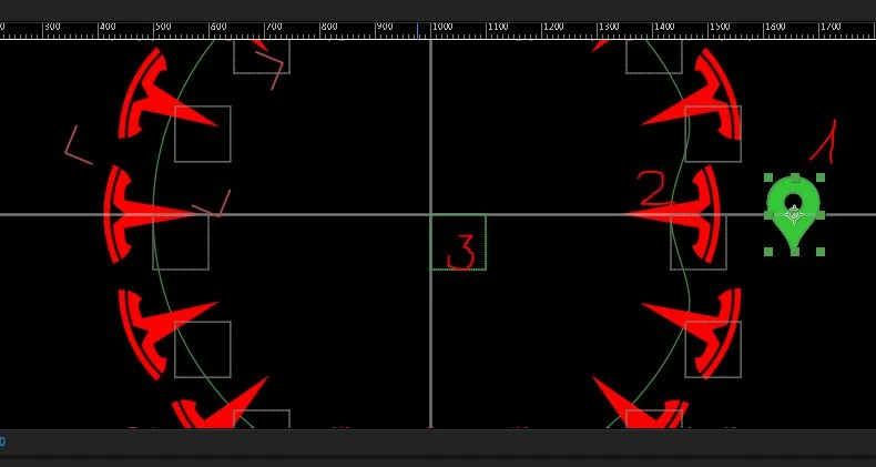

Nov 15, 2023 11:28 AM UTC
Thank you @dfred23
Your approach would be great if #1 would only move in the X-axis, like this:
The goal is to rotate object #1 around the circle. When #1 moves away from #2, #2 should return to its original position. However, it does not do this with this approach if #1 is moved along the Y-axis:
So I think the distance between #1, #2 and #3 has to be measured.
Thanks!
