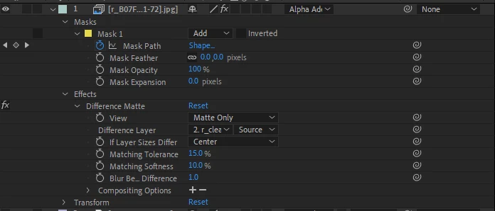

Whenever I create a mask in After Effects, it generates a thin white line where my mask border occured in preview. It also shows up in the renders. This is at full size render. How do I remove this line?

Solved it!
The issue is that including the mask in the same layer as the difference matte was causing too many clashing calculations. The solution is to duplicate the layer that needs masking, apply difference matte to one and all other masks to the other.
Layer it so that the difference matte is above the masks and using the Track Matte on the masking layer, apply it as an Alpha Matte.

Try adding the effect "Simple Choker," set to 1 pixel. Should clean this right up.

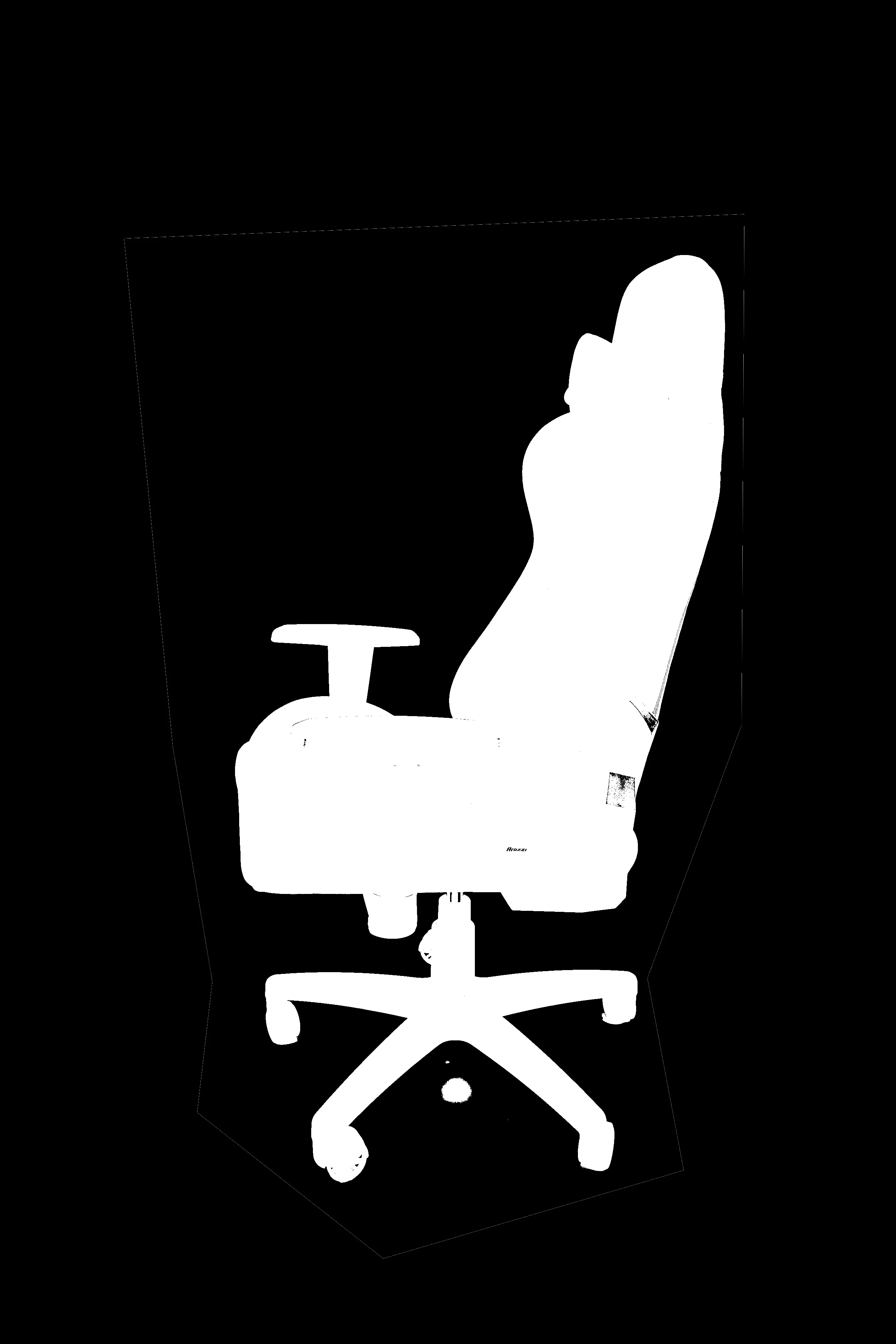

The source files are JPEGs which are just compressed from the RAW images. This attached image is a mask generated from a difference matte. Those white lines comes from further refining the mask generated by the difference matte. This is all created from 2 layers. The one screen capped below. And a clean plate.
It's an aliasing error caused by premultiplication and I genuinely have no clue how to get rid of it as I'm trying to render out the mask image sequence. So these mask border lines are showing up in my image sequence renders.
