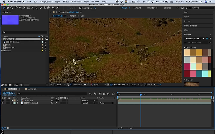

To the right of this clip on the mountain it is possible to see the drone operator. I am trying to use After Effects to hide this by using a mask, but because the scale is changing as the drone moves in, and the background scale is also changing, I can't seem to find a suitable anchor point so that the mask of a rock ,to hide the drone operator, stays still. Can anyone help me to do this?

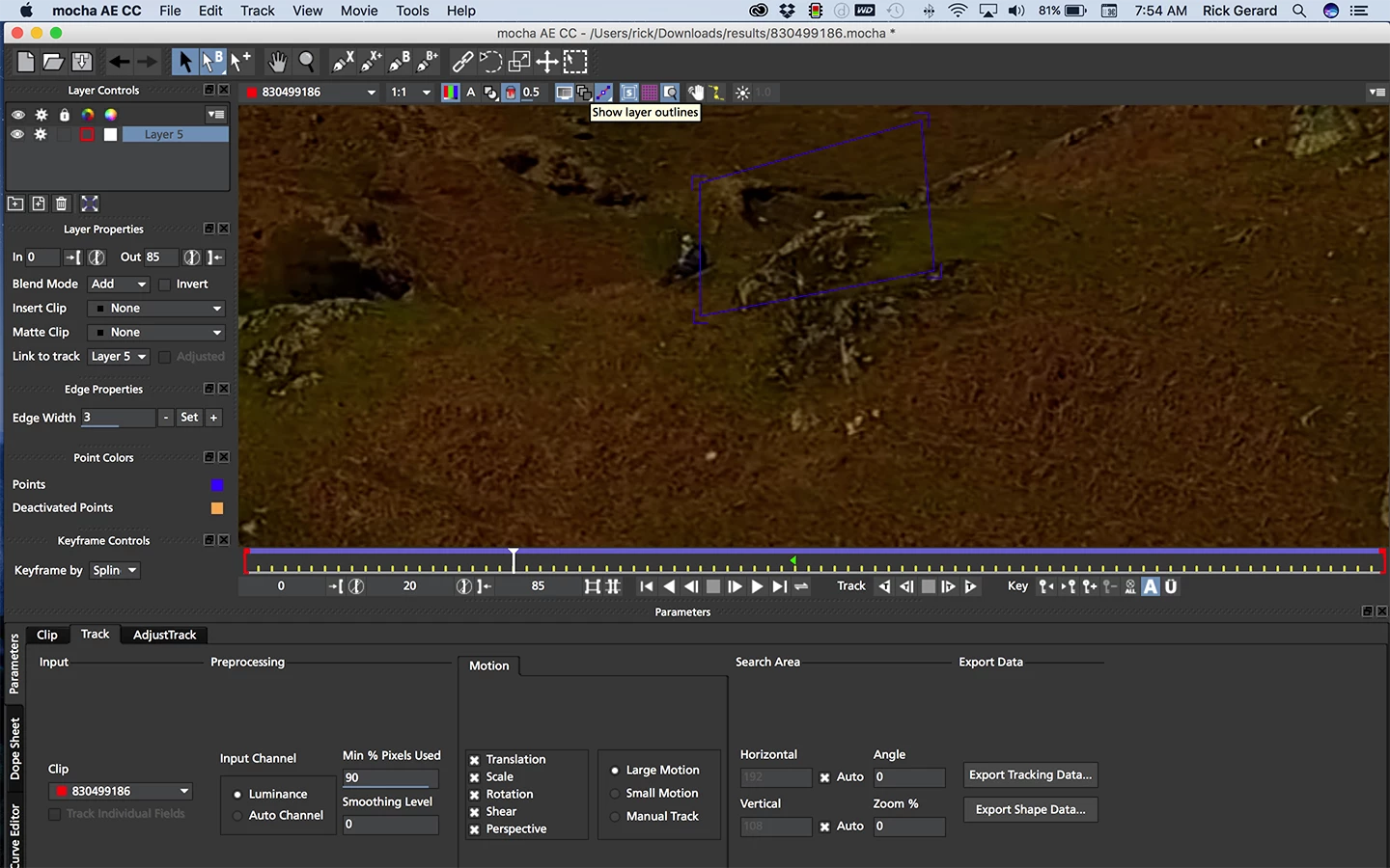

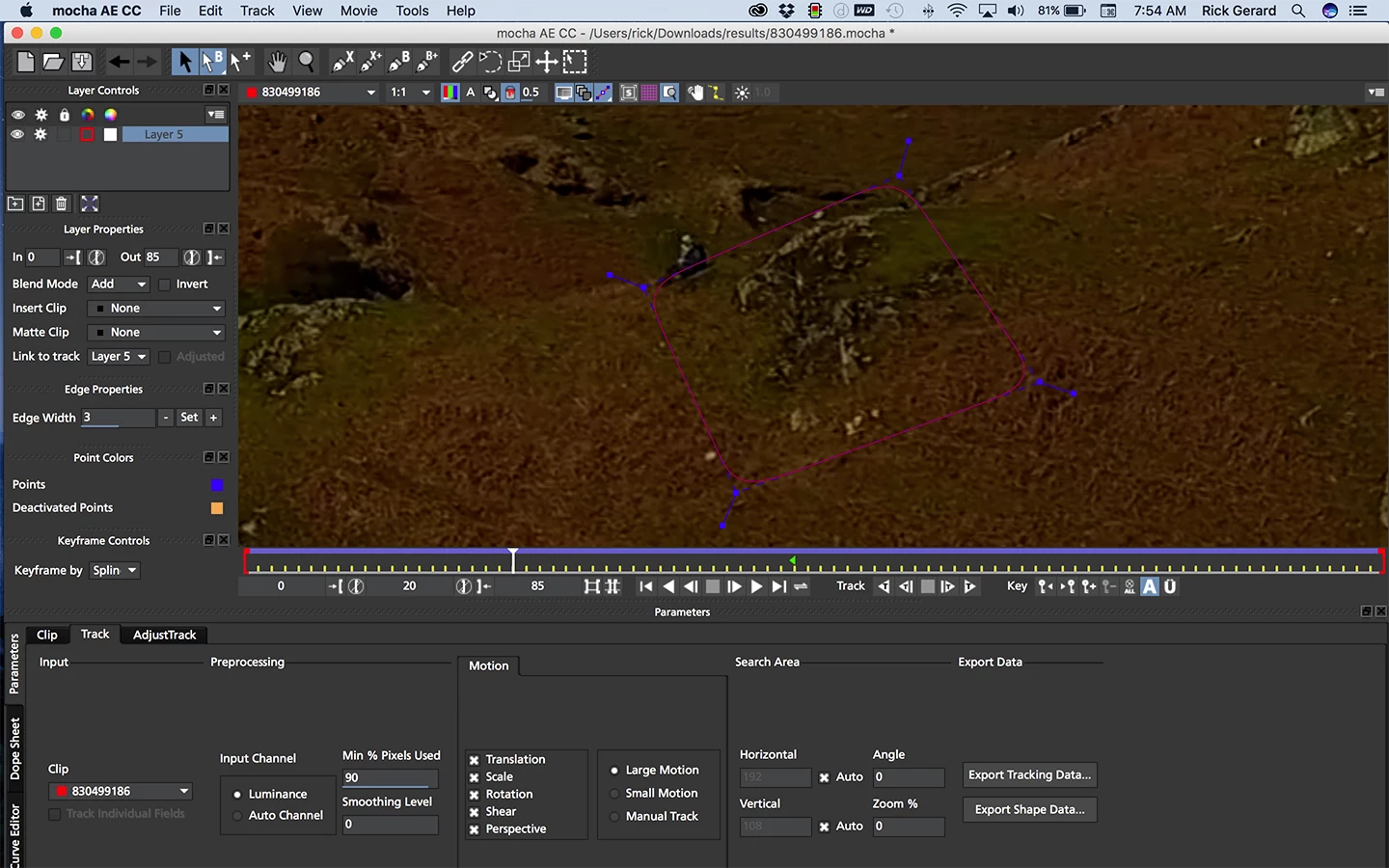

After duplicating the original footage, pre-composing, opening the pre-comp (called corner pin) and setting up Corner Pin/Power pin on the original footage so that the corners of CC Power Pin were tied to the corners in Power Pin with an expression I would track the footage in mocha. The area just in front of the pilot provides a good plane to track. Make sure you have Perspective turned on.
The next step is to set up the surface to that it matches the perspective in the shot like this:
Note that the surface extends above the ridge to give me some image that is moving on another plane to clone from. I usually add a grid to check the track and make sure things are sticking well.

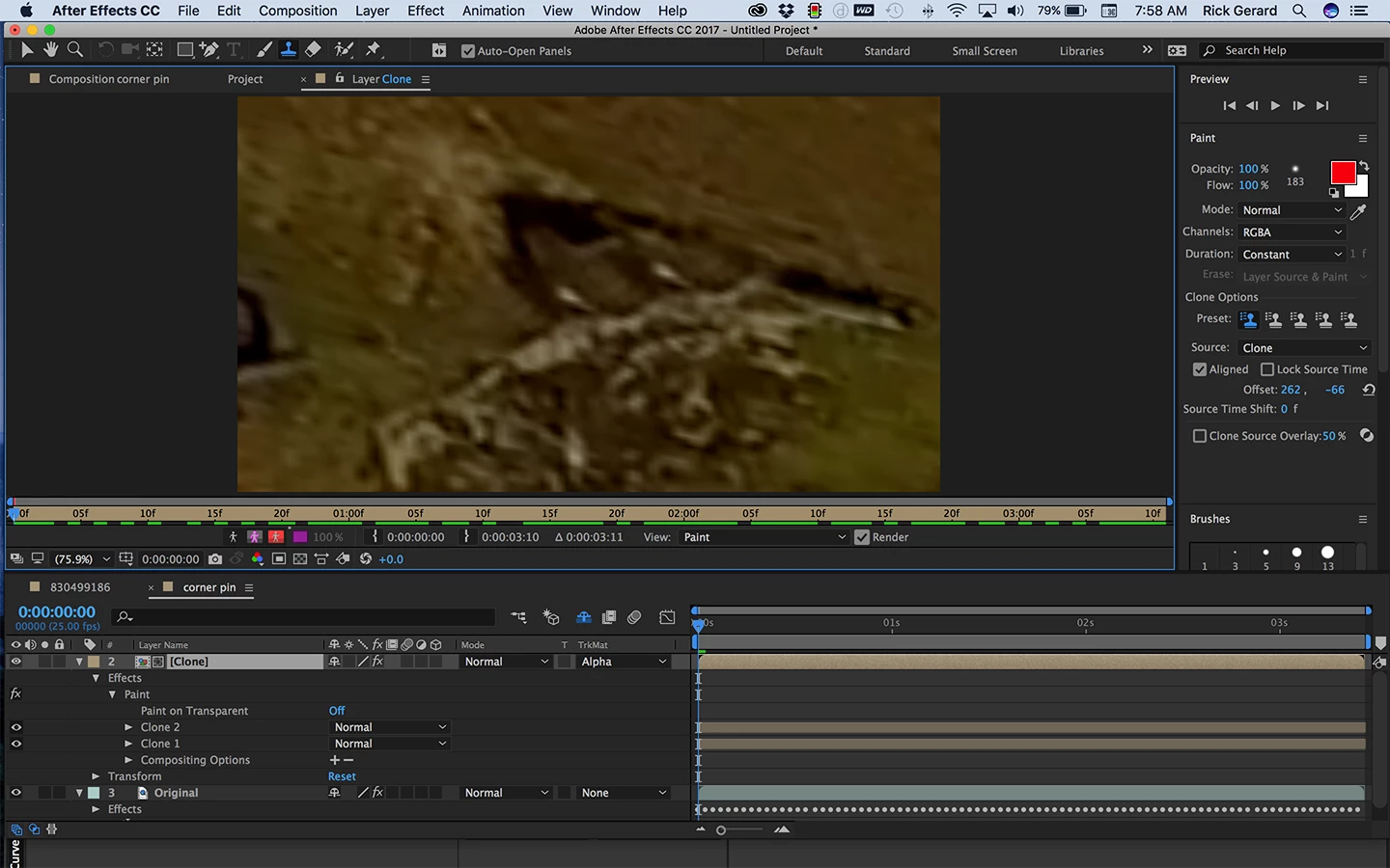

Back in After Effects you apply the corner pin data from Mocha to Corner Pin by selecting it in the Effects Control Panel and pasting. This should give you a zoomed in and stabilized field to work with. Duplicate the stabilized footage and then pre-compose the top copy and call it clone to get ready to paint. Open the Paint workspace and inside the Timeline open the Layer panel for the "clone" pre comp and set up your clone tool to copy an area from the valley behind the ridge so it covers the drone pilot. You don't have to worry about covering up the rocks in front of the pilot because you are going to mask the layer later. The clone tool is set to continuous.

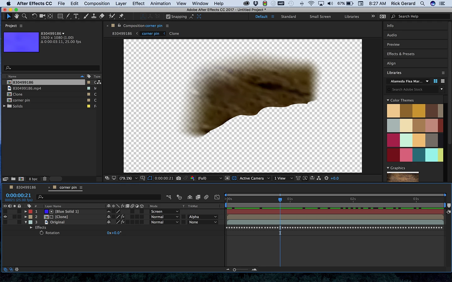

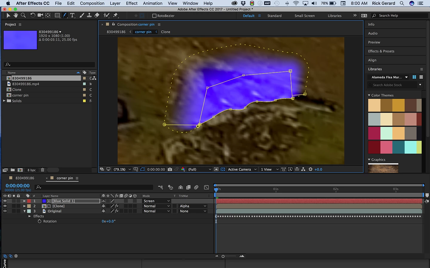

When the area behind the ridge looks good enough to you go back to your standard workspace, add a blue solid on top, set the blend mode to screen so you can easily see through the mask and set up a feathered mask to reveal just the area behind the ridge
Because you stabilized and corner pined the ridge and rocks in front of the drone pilot there is very little if any key framing to do to get the mask to follow the rocks. Then you set the mask layer as a track matte for the clone layer, turn off the original footage so you only have the cloned layer visible and you are ready to go back to the main comp.
Paste the corner pin data from mocha to the nested comp in the main comp and you're done. The drone pilot has been replaced with a nicely rotoscoped moving background and no body is the wiser.
