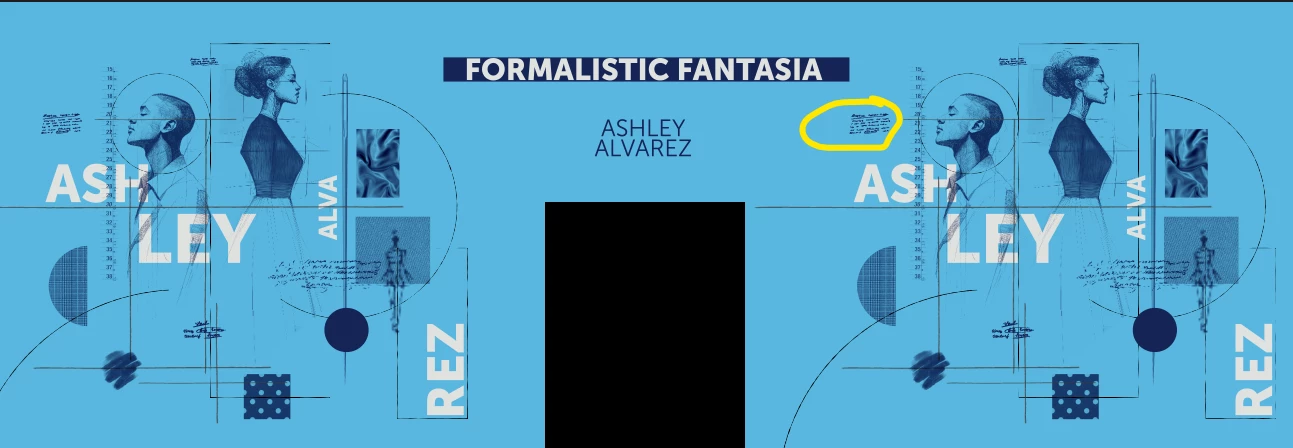

I have the same problem and frankly, CGGZ, I wouldn't knock yourself for being a photoshop user and feeling like this is confusing.  I work almost exclusively in After Effects and have for over a decade and it doesn't make a ton of sense to me.  Give the attached a look.  Everything is 2D.  Logically you can understand why I might want all the design elements on the left in a precomp.  Why? Because all those elements are repeated on the right.  I'll animate within the precomp which will automatically apply the animation to both sides.  All of the darker color elements in the design require me to use Multiply, but I don't want to Multiply the entire precomp because of the white text.  Hence, collapse transformations as my solve.  That's all well and good until I say, "hey, it might be nice to remove this one piece of text on the right to give me a little space to drop the text in the center down a bit" (see area circled in yellow). However as soon as I do that, the blending modes disappear and it all breaks.  Ok fine, maybe it's just a mask, issue, let's try matteing it instead.  Nope, same problem.
I can obviously do any number of work arounds to get what I want (I can split the white text out so I can multiply the precomp and get rid of collapse transformations; I can remove that one element and put it in the main comp instead; etc etc).  But it really seems silly that it's too big of an ask to both want to mask a precomp AND keep the blending modes inside.  Just don't quite get the math going on in the background that makes it operate this way.

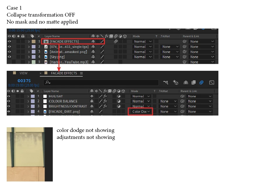

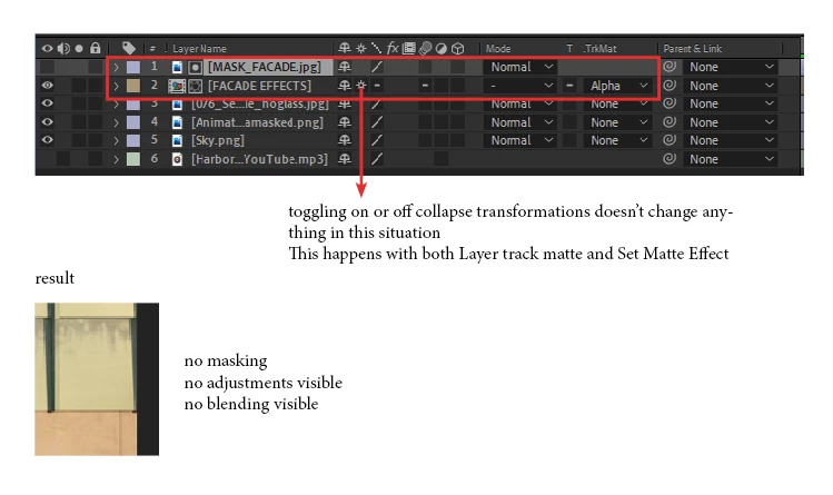

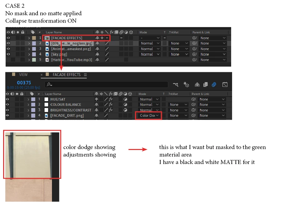

I am not working with 3D layers but just jpgs rendered form 3DS max.
Here is a better explanation of my issue that hopefully can give you more insight:
