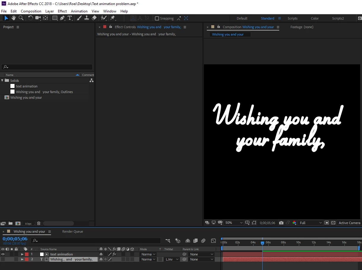

I am working on a write-on animation using mask paths on a solid layer with animated stroke.  The solid is above a stylized text layer and I am using it as an inverted luma matte to reveal the original text.  The problem is that one letter (o) keeps creating a fill instead of a stroke and I cannot figure out how to stop it from happening. There is no option available to turn off fill or stroke so it seems that it should only be using the stroke effect I assign to the mask path. I have never encountered this before and I'm going crazy.

    you don't have to do that. simply changing it to "none" will disable the mask functionality. I am not sure why you say it doesn't work. I have seen your project file - you did not setup the alpha matte correctly. as you can see in the GIF's I posted, your stroke works fine, the masks are disabled, and it works as well as a stroke should work. what is the problem now? here is your fixed project file, examine it and see if you have any further issues:

    I can't visualize what you are talking about without a screenshot. I don't understand your workflow at all or what you mean by the letter O creating a fill instead of a stroke. Show us the modified properties of the layers giving you problems by pressing the U key twice, Printscreen and paste so we can see what's going on.
    Here's how I set that kind of project up. The stroke is modified to round cap and round join. I start with a stroke width that is a little narrower than the text so I can easily and accurately set the position of the path. Then I add Trim Paths and select Trim Multiple shapes Individually and change the shape layer to an alpha matte and I'm done. It's a lot easier to animate the timing this way. All that is left to do here is increase the stroke width and set the track matte. The timeline is about 60% through the animation.

    Thank you for responding.  Alpha Matte does not work properly either.  Changing up mattes or the three options (over transparent, original, reveal)  does not yield proper results either.  The stroke effect with the luma inverted or alpha matte is one single thickness and does not display the underlying text in its nuances of thickness:

    this is your problem:
    your paths should set to none. on the "O" they are the only ones who are closed path and are masking your solid (which is white) this is why you are getting white circles. change them to none.
    BTW, for this type of path reveal I would not use "stroke", I would use "Write-on" which gives to the ability to set variable stroke through time.
