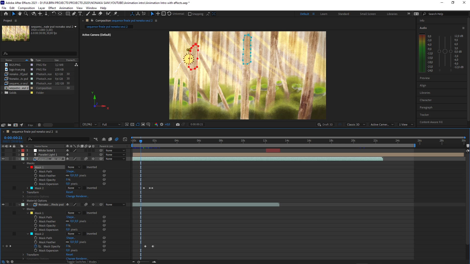

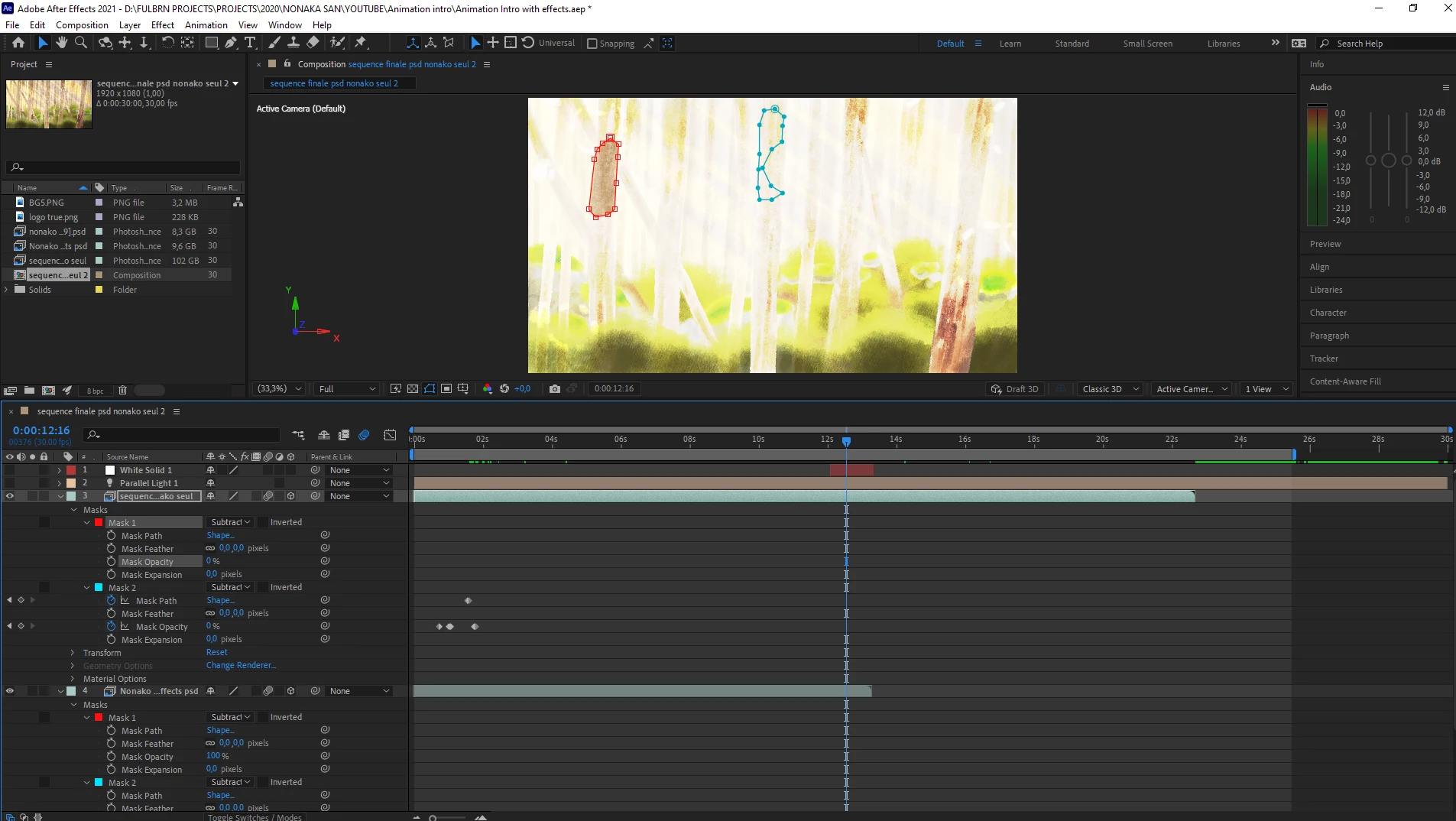

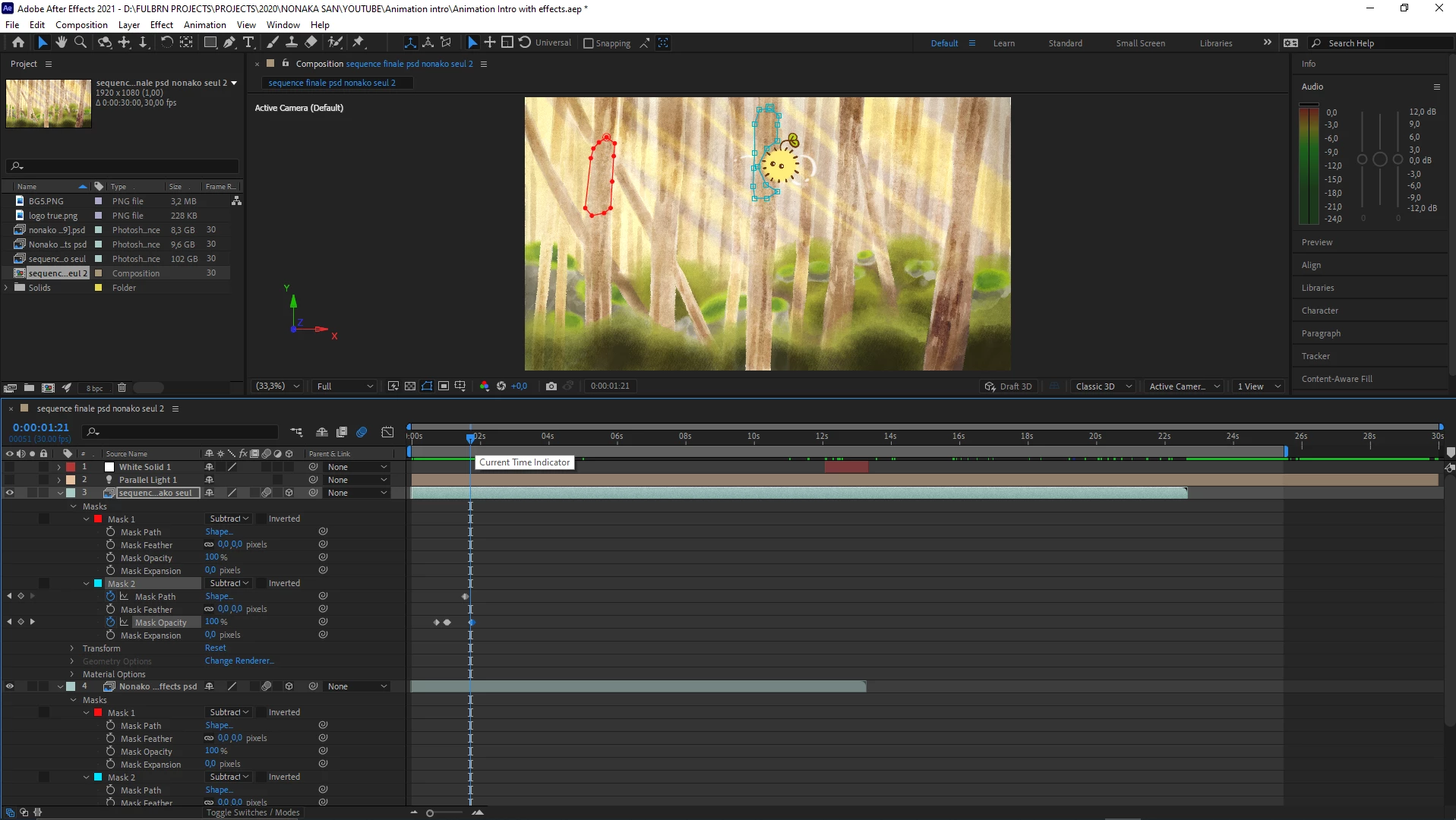

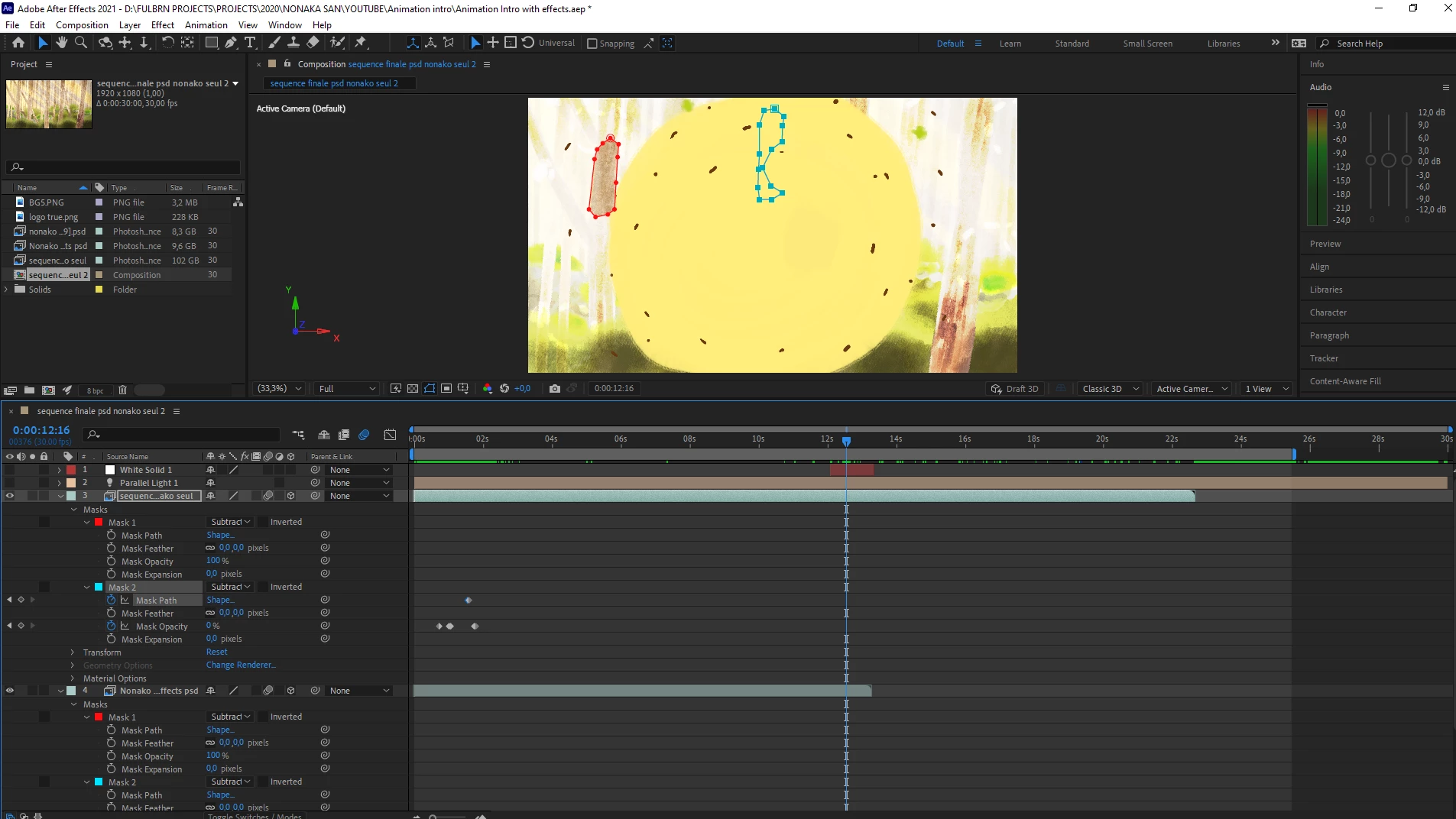

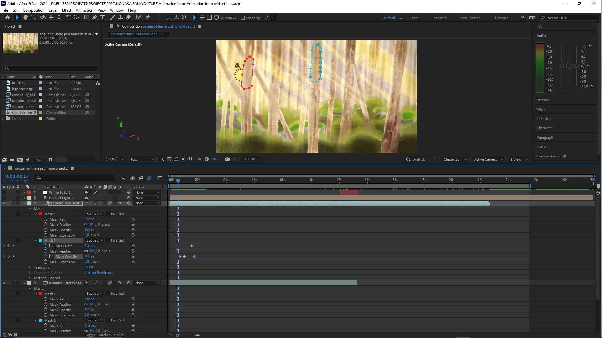

Sorry for the late answer!
Here it is. Is that what you needed?
(Note: I have two animated sequences (one is the character and the other is animated light effects) inside which I applied  two mask layers in the same configuration for both sequences)
While making the screenshots, I realized that if one of the mask (red) was on mode "substract" with opacity: 0%, it would make the character disappear. Yet the other one (blue) doesn't seem to have that issue.
When I make keys to make the masks "disappear" (by reducing its opacity levels to 0%) so it doesn't block future moments in the animation, the (blue) mask work very well, but the other one makes the animation disappear instead.
I put description in each image title to make it more clear. On the last one I didn4t bother to create keys for the (red) mask, it was just to show how it behaves with 0% opacity. I tried with keys before, it didn't work so I deleted it because I thought it was part of the problem.
Should I move the masks out of the frame instead of using opacity levels?
