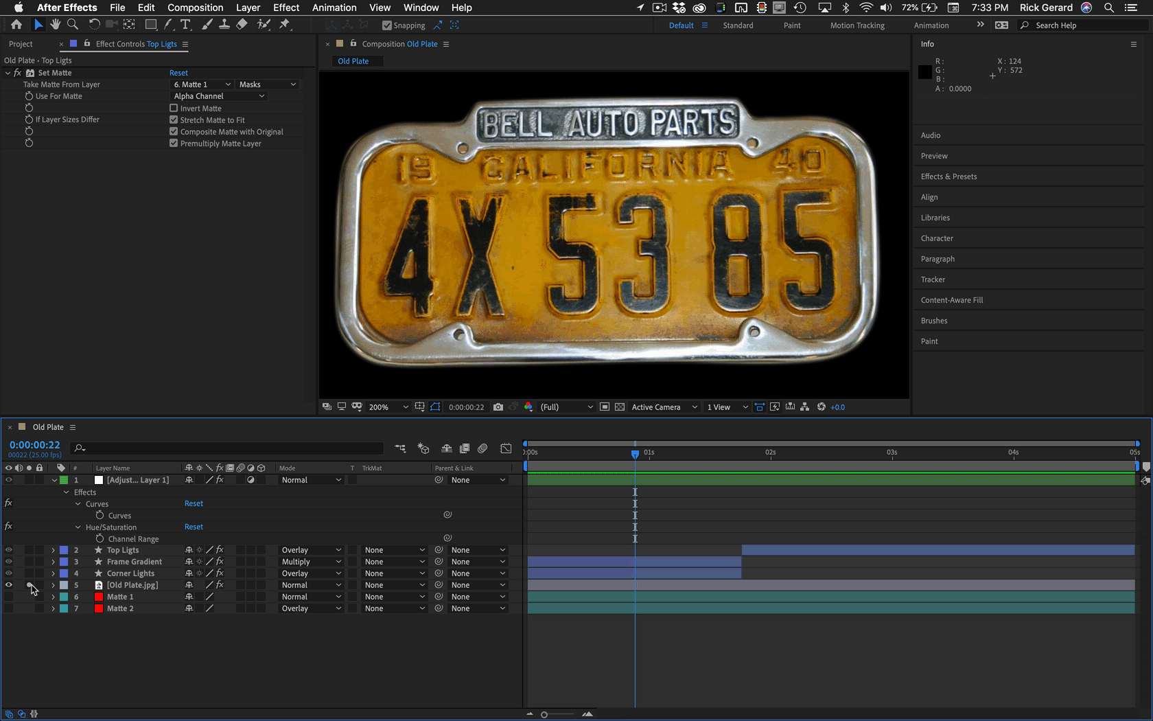

You have two options, maybe 3. Go to Red Giant and take a look at the VFX Suite or Red Giant Complete. There are tools there that will automate the process for you.
The other option is to work with additional layers, gradients, blend modes, and color correction tools to match the lighting. Depending on the shot, this could be 2 layers or 40. For example:

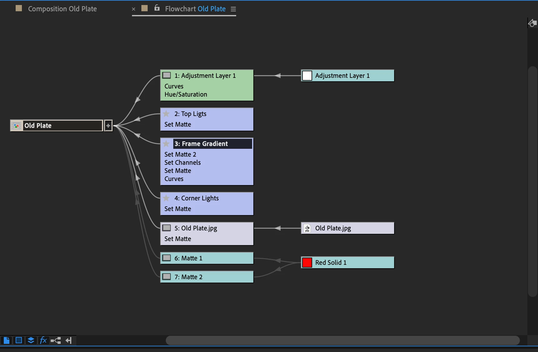

The basic plate is cut out of the background using Set Matte from a masked Solid called Matte 1, Then shape layers with multiple gradients are overlaid to light up the plate and a frame gradient was created from a combination of inside and outside mattes to overlay on the plate frame with a blend mode and transparency. The flow chart shows the effects used and you can see the blend modes in the animated gif. When you get the lighting matched up pre-compose and add the fixed plate to the shot. I honestly have had to use 40 or 50 layers to match the lighting in some scenes. Red Giant's compositing toolset makes this a lot easier, but you can do it by hand. I've been doing this kind of lighting matchups for more than 25 years.
The flow chart for this sample   - took me about 15 minutes.
