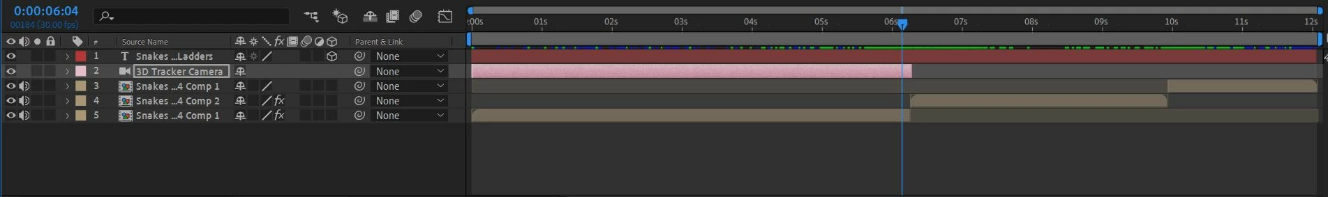

Hello there, I am very new to After Effects (started last week) and for my first project, I've been using the 3D camera tracker to track text onto the stage of a dance performace. To make it easier for the tracker to track the video, I split the video into multiple layers for the zooms and fixed views. The video tracks fine, but when I create the text and camera, I have multiple layers of text. I have to then, by hand, match up the last frame of the first layer, to the first frame of the next layer so the different layers of text are in the same position for the whole video.
I have also tried creating one text layer and after the tracker is finished, I will just create the camera under the effects of the current layer but that will cause the text on the other layers to jump around a lot.
Is there an easy way to do this? Am I using the tracker wrong? This really slows down my workflow so I am hoping to find a way to speed it up. Thanks.

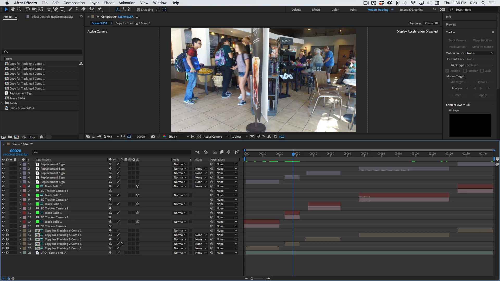

Layer 3, 4, and 5 are all nested comps of what I assume to be the footage of the dancers. I don't know what is going on in those shots, or whether the layers have been scaled or moved, but there are 3 layers in your comp that are nested comps with the same name so there need to be 3 cameras, one for each layer that is camera tracked, and 3 text layers that match all 3 shots.  You will have to establish an origin and ground plane, add a camera and a track solid (reference solid named Ground and set to a guide layer with a layer marker on the frame you used to set up the origin) using the same points you used for the Origin and Ground plane, then you need to add reference solids or text layers to the appropriate geometry in the scene. You'll have to keep track of the location and orientation of each piece of geometry you use in each scene so that the cuts work.
I hope this helps. You would be better off using a separate comp for each shot in this 3 shot sequence, then editing them in Premiere Pro.  Since it is only 3 shots you can probably get away with just these 3 shots, but if you have more than a few seconds and shots in your sequence it is usually better to cut them up into short sequences.
I did a shot for a short film last year. The shot was about 145 frames long, it all had to be camera tracked, but an actor crossed in front of the camera 4 times blocking most of the background and all of the part of the scene that needed fixing in that single shot from the Premiere Pro sequence. I started with a comp that contained just the original shot. I duplicated the footage layer then proceeded to split the layer every time the actor blocked the camera. Each of the duplicates was trimmed so that just the part of the shot that needed fixing was retained. There were holes in the split layers, but the original footage on the bottom layer was there to fill the holes.
All 5 edited layers were pre-composed trimming the new comp to layer length. This was one time I just kept everything in one comp. I then ran camera tracking on each nested comp, added the reference solid and the replacement element for the scene, and set the nested comp as a guide layer because I only needed it for camera tracking. My shortest camera tracked shot was about 8 frames. My longest was about 40 frames. The completed comp had 5 cameras, 5 origin guide layers, 5 copies of the repair, and 5 placeholders. That is how you set up a comp with multiple cuts of the same shot. This is what it looked like:

August 28, 2020
After removing the tracking points that are on the dancers, the text is tracked smoothly in both layers, but if I try to resize and move the text to the correct position in the second layer, it's in the wrong place in the first layer. If I split the text layer to match the length of the different layers, I can resize the text freely without messing up the other layer but then I will have to match the size, orientation and location of the text on the second layer to match the last frame of the first layer so that it looks like one smooth text layer with not cuts.
I'm unsure if that makes any sense, if you need me to clarify something, then let me know. Here's my timeline currently if that will be of any help. "Snakes and Ladders" is the name of the dance.
