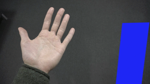

I'm fairly new to AE and mocha and hit a speed bump.
I've created/tracked a plane in mocha AE and I'm trying to apply a shape layer to move just like the plane, see gif:
I made a shape layer right over my hand, but when I apply the tracking data it gets offset (and the height scales strangely).

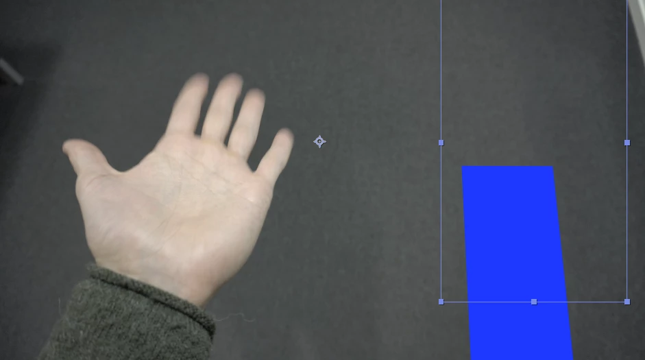

When I try to move it to be over the hand it gets clipped, see images:
Image 1: shape layer is offset:
Image 2: layer gets clipped:
The tracked plane and shape layer are acting the way I want them to, just not in the right place. I've tried moving the entire shape layer as well as editing the point of origin but to no avail. Any ideas on what I'm doing wrong?
Thanks!

Shape layers calculate their coordinates from the center, not the top left corner like otehr layers or for that matter mocha. The immediate solution therefore would be to use a standard solid, not a shape layer. Otherwise it could of course be fixed by recalculating the coordinates with an expression or massaging them in mocha.
Mylenium
