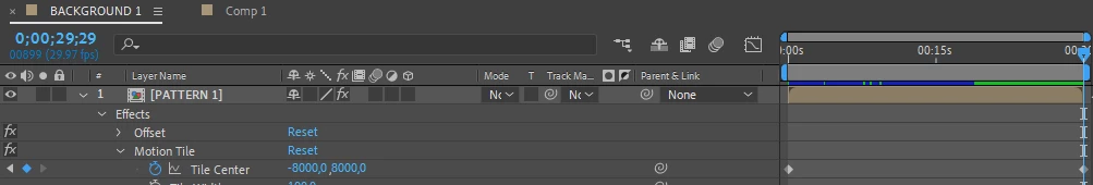

Alright so i'm working on looping backgrounds, so far i created 6 of them :
they pretty much all follows the same animation :
keyframe 1 at 0;00;00;00 :
Tile center 0,0.0,0
keyframe 2 at 0;00;29;29 :
-8000.0,8000.0

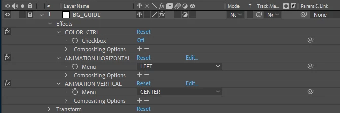

i created an adjustment layer (BG_GUIDE) that i'm using to control my backgrounds
i created two dropdown menu ('ANIMATION HORIZONTAL' & 'ANIMATION VERTICAL')
with 3 Options
ANIMATION HORIZONTAL : 1 = LEFT (-8000) ; 2 = CENTER (0) ; 3 = RIGHT (8000)
ANIMATION VERTICAL : 1 = TOP (-8000) ; 2 = CENTER (0) ; 3 = BOTTOM (8000)
Since motion tile center is given in 2 value [x,y], what i tried to do is use 1 menu for 1 value and 1 menu for the other
(i did this this way because i learned how to use expressions through a few tutorials so my knowledge is super limited)
what i have no idea how to do is limit this to the second keyframe and not the entire composition.
