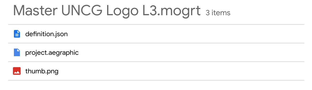

   When I export a Mogrt from AE, I export to a local drive, then upload to my Google Drive. Strangely, it separates itself into parts and doesn't work in Premiere.
Any ideas?

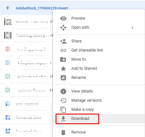

    Hi karaleeg04,
    I tried testing this on my machine. When I uploaded a MOGRT to Google Drive, it shows up as a MOGRT but if you double-click it, it shows the components inside.
    I found out that downloading the MOGRT without going inside it works just fine.
    Hope this helps.

    Hi karaleeg04,
    Hope this helps.
