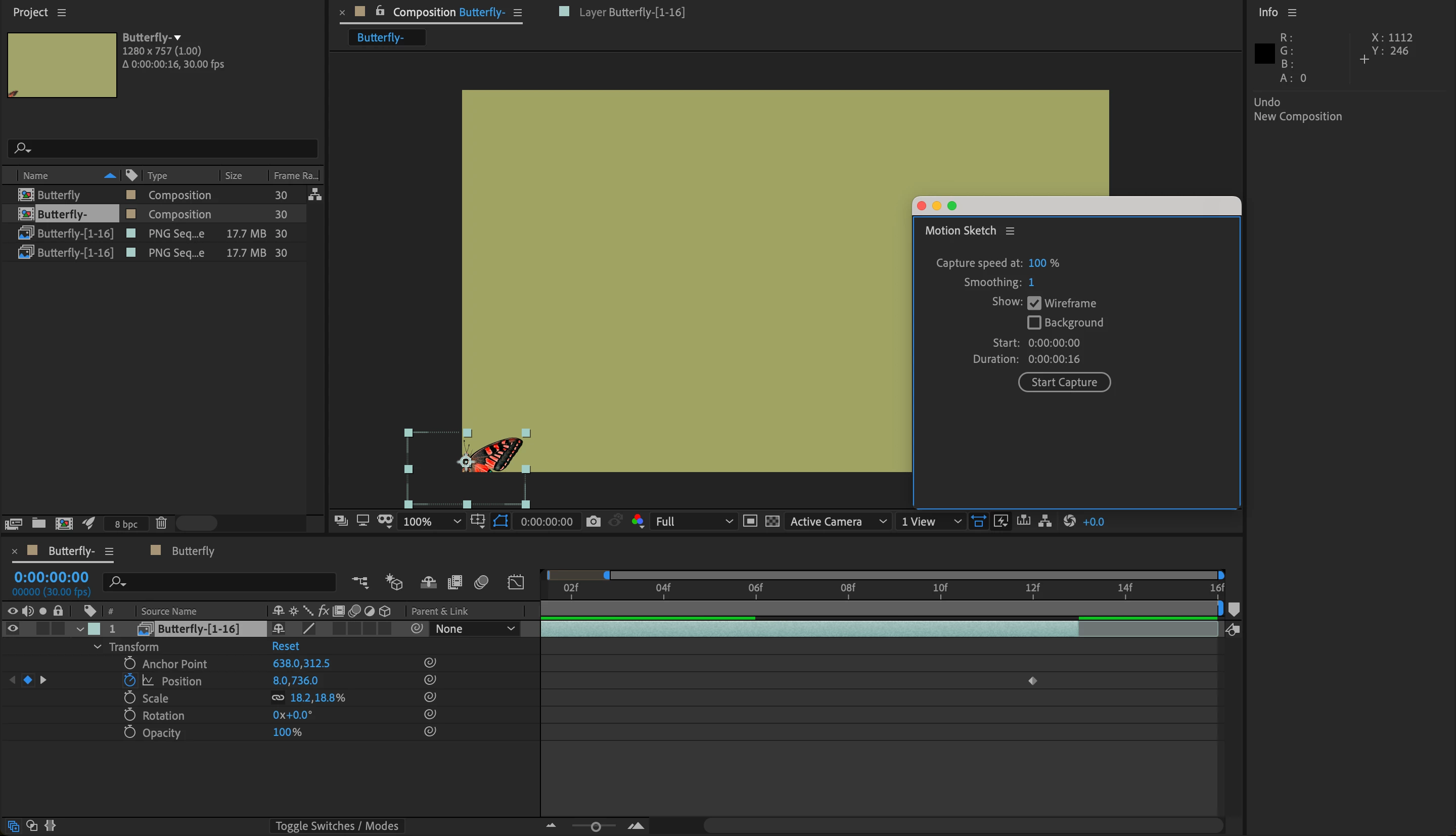

Hi
I'm using AE 2020 and I intend to animate the butterfly using the motion sketch button. But when I click on start capture the ends abruptly without capturing the full range of the motion. The result is only a small area that is covered.
Please help.

Hi
Thanks for replying. I did, but the problem persists.
I intend to increase the duration of the motion sketch but the farthest that it can stretch to it is 0:00:00:16. I tried increasing the duration and even changing the timeline to show seconds instead of frames. But even that isn't happening. I changed the project settings to Timecode, but it doesn't show the S that I want to see.
So, I have run into two problems: Increasing the duration of the motion sketch and wanting the S instead of the F.

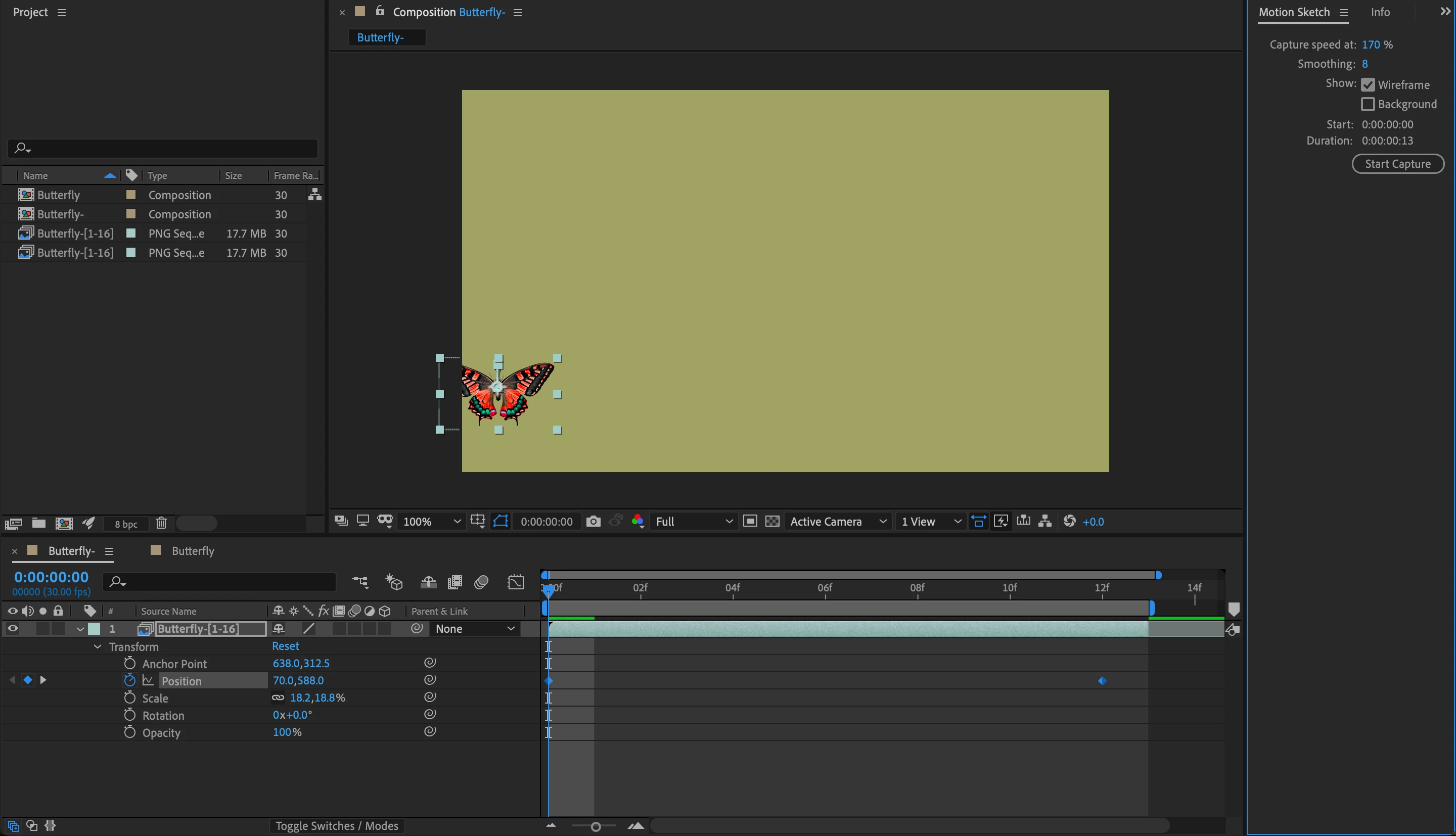

Jun 20, 2023 6:11 AM UTC
Hey everyone!
Thanks for taking out the time to help.
I kept messing around with the interface and got the solution: Increase the second count from the Composition settings and with this increased duration the motion sketch has a larger area to function. And when the duration is increased the timeline appears in seconds(S).
