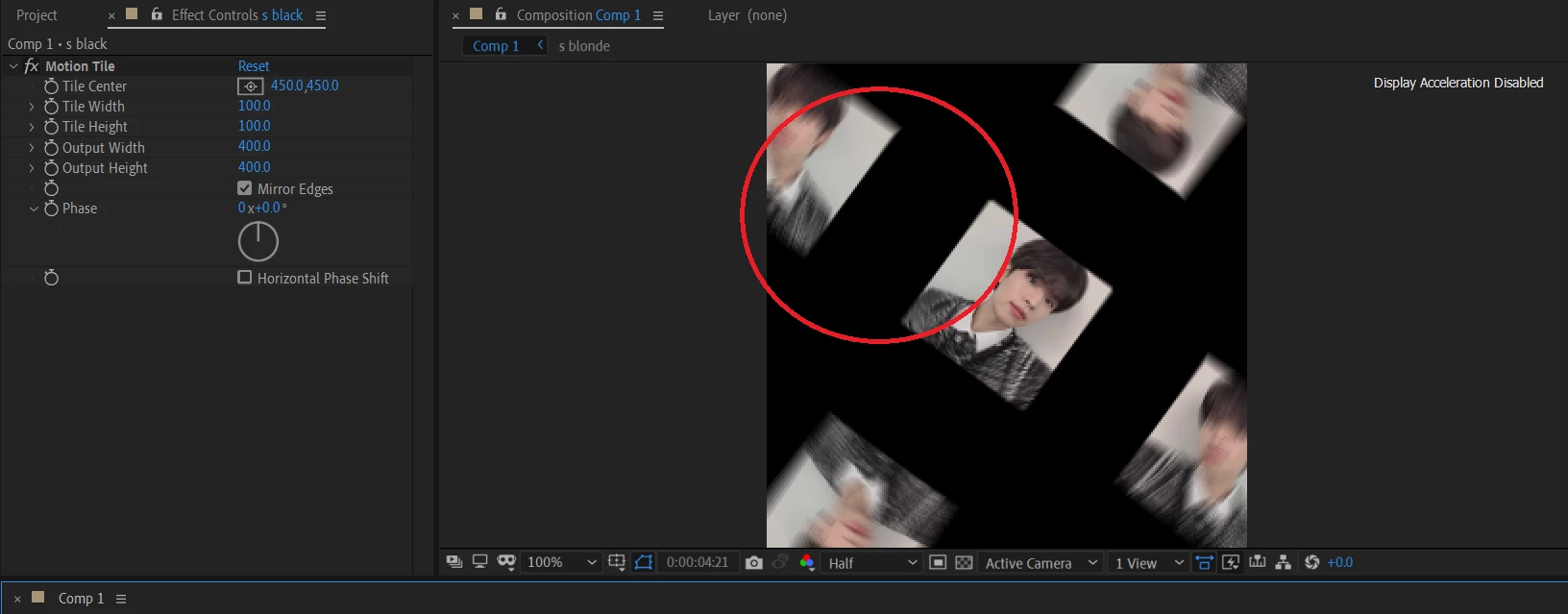

hi, im having a few problems with the motion tile effect on after affects, ill send a picture below.
how can i make it so that the tiles effect is directly next to my original picture without the black spaces?
April 4, 2021
you have to pre-compose the clip/picture you have motion tile on, then open the pre-comp (double click) and increase the scale. I hope it’s understandable 🙂

April 4, 2021
hi, i just tried that and it worked! thank you so much!!!
Mylenium
April 4, 2021
Adjust the tile width and height parameters or "crop" the image by putting it in a suitably sized pre-composition. Basic AE stuff. You may want to read the online help.

zainab.Author
April 4, 2021
ah right, thank you so much! i'm fairly new to ae so i'm not sure about some things.
thanks again
