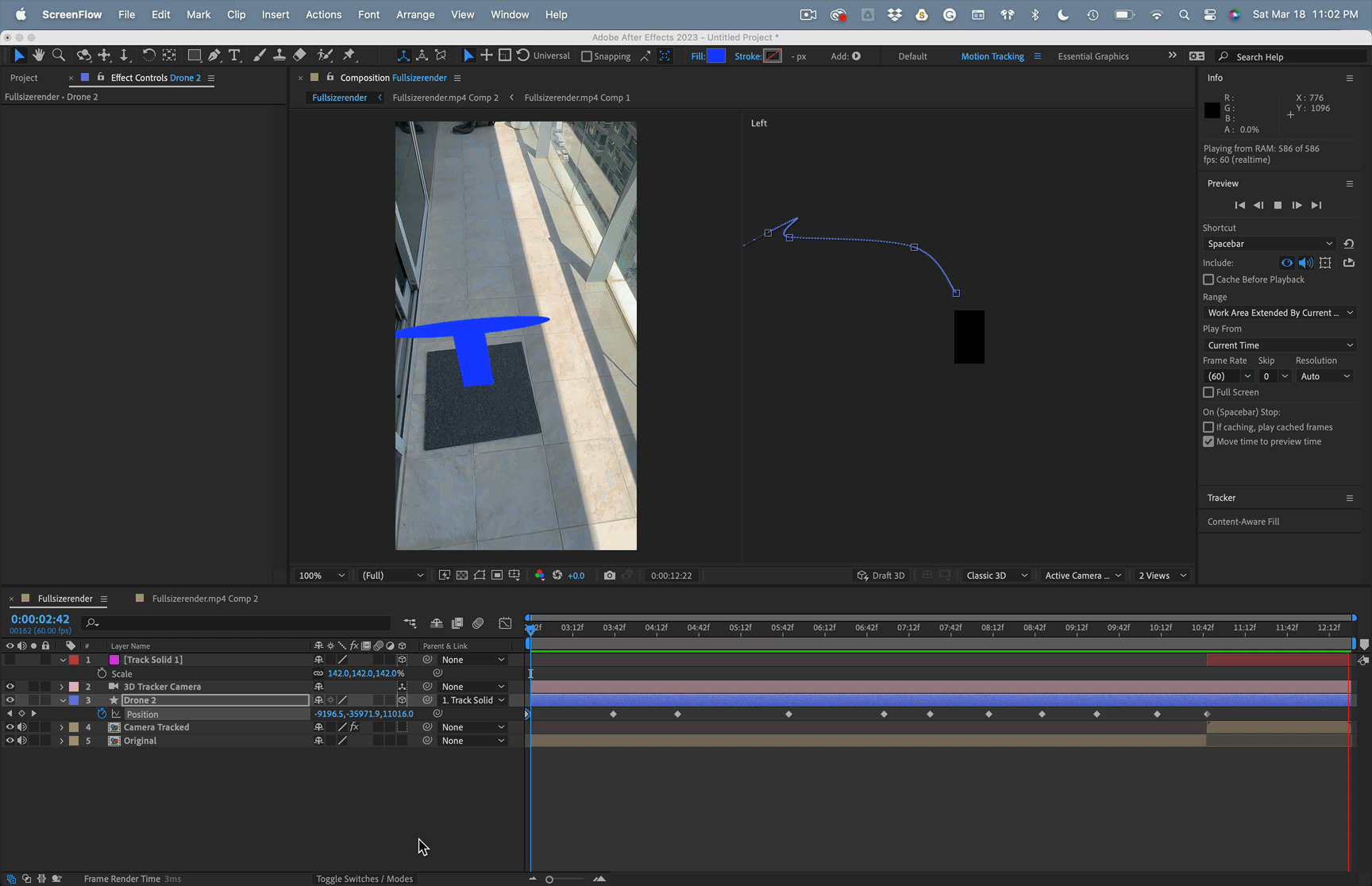

how can I do that like a drone coming to deliver a product but its not just a simple footage its like camera scene is changing from building to sky and then to my balcony

Look at the project file. I just picked where the drone was on the ground, tracked the part of the shot that I cut, then went backward using just he left and active camera view to move the drone up and away in a path that kind of makes sense.
That whole shot will never camera track. About the only part of the shot that would track was the last few seconds. When I got the Track Solid attached to the landing pad, I just Shift + Parented the shape layer drone to the Track Solid and rotated it so ti stood up.  Then I just worked backward. The path was random and all I wanted to do was to kind of keep the drone in the shot and move it farther away from the camera. Once it is in the air, the path would have to be created by hand anyway.

If you want to try something with that shot, I suggest that you decide where and when you want the drone to land, split the original footage layer there, and camera track just the last part of the shot. Set an origin and ground plane on the landing pad, then add a Track Solid there. Make sure that the solid sticks to the landing pad. That is now the landing spot for the drone. There will be no camera movement before the in-point of the camera-tracked section, but the camera will be there.
If the landing looks good, set a keyframe for the drone's position and rotation properties, then just animate the position in the frame back to where you want the shot to start.
I did basically that and got this with just a shape layer simulating the drone. It would be a fool's errand to try and camera track the entire shot.  All this needs is an actual 3D model, some lighting, come clean up on the simple motion path and a little rotation animation, and a track matte to allow the drone to come from behind the building. It took me about 10 minutes.
You should be able to get started from that explanation. Let us know if you have any trouble. I've included an AEP file for you to fiddle with. You'll have to use your footage.
