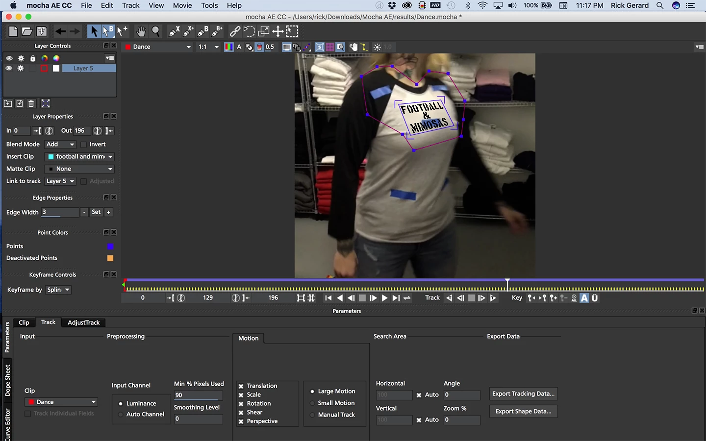

    Here's the shot tracked in Mocha:
    Notice that perspective is checked, that the spline includes the areas of detail that are approximately on the same plane and I have imported your graphic to add to the surface. This track worked pretty well but as you can see by the layer name this was my fifth attempt to get a good track. Because you have a curvy actor it becomes necessary to track at least two planes to get a good composite. This will take a lot of work.
    Having someone walk across frame and then turn to the front requires that the plane you are trying to track is fairly flat, that you see most if not all of the surface in the shot - which eliminates a profile shot that obscures all of the back edge of the plane. It's all a matter of careful blocking.
    Adding a graphic is much easier than replacing one because you don't have to generate a clean surface for the new graphic. Just blend modes can simulate the graphic distorting on folds in the fabric.
    Another option is to motion stabilize your shot so the shirt does not move in the frame then add your graphic. This technique involves a TV screen but it would work just as well for a t-shirt given the right blocking.
    I would practice on a few shots and experiment with Mocha's workflow so you can learn how to block the shot so the composite will work well. If you have to have the actor move in profile and then turn toward the camera it might be better to put a cut in the shot and shoot from two angles or do two separate tracks and combine the composites using multiple layers. This will give you only a few frames that need to be adjusted by hand to cover up the transition from profile to head on.
