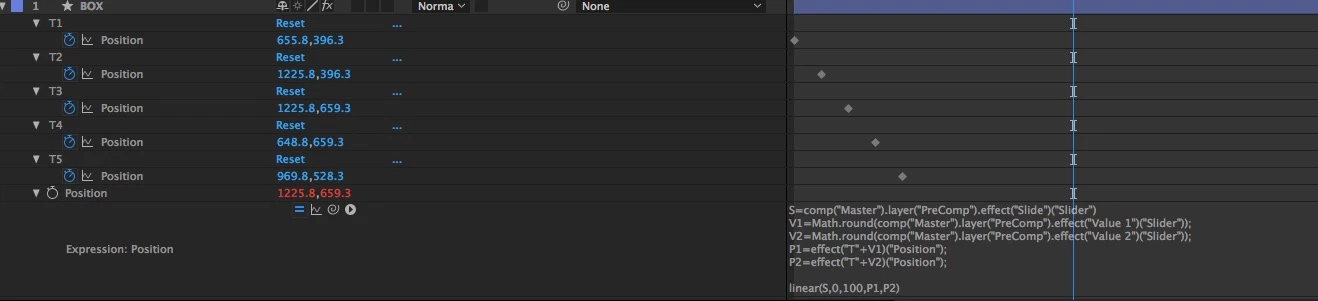

Hey Deepongi, only way I can think to accomplish this is that instead of using time-remapping, you setup a linear slide with variables based off of index values that you can assign to two value sliders. I've set up a basic example in this project.
https://www.dropbox.com/s/1sspaw0fozayc2l/Slide%20Between%20Multiple%20Values.aep?dl=0
Effectively it's a box with 5 "Transform" effects on it that are all turned off, each has a unique Position Value and are named sequentially "T1", "T2"..."T5".
Then in the actual layer Position there is an expression that outputs value based on 3 sliders in the master comp.
Slider 1 (S) = 0-100 for interpolating between positions
Slider 2 (V1) = Value of which position is "Position 1"
Slider 3 (V2) = Value of which position is "Position 2"
Then two variables that give the various T1-T5 position values based on sliders 2&3.
P1=effect("T"+V1)("Position")
P2=effect("T"+V2)("Position")
Final output is a linear slide between P1 & P2 based on "S" slider, this gives you a keyframe controlled interpolation between your values.
linear(S,0,100,P1,P2)
This is a very basic example of the effect, however it does give you interpolation between separate values.
Hope this helps
