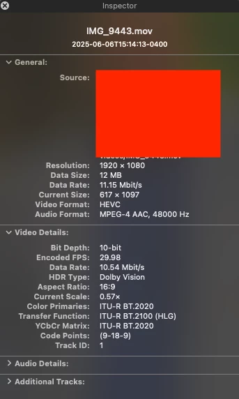

Aug 20, 2025 2:00 PM UTC
Thanks for the reply Kevin,
I was able find this info about the video itself in quicktime (see attached). Does this help you or anyone decipher further what my problem is and how I can fix the issue in after effects? I've been trying other color modes but i'm not sure if im doing it properly.
Thanks again for the help! I really appreciate it.
nishu_kush
Aug 28, 2025 2:51 PM UTC
Thanks for the screenshot. Your issue could be related to gamma. Please check out the following article for more details: https://adobe.ly/4lZOeTu
