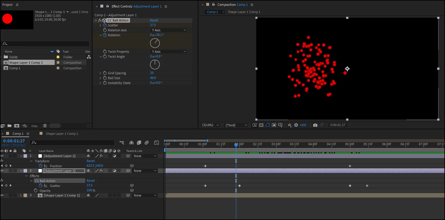

I just had a play around with CC Ball Action.  It might be worth seeing if that effect can do what you're after:
If you mess with the scatter, rotation and twist properties you can create a transform like effect that can return to static positions.
