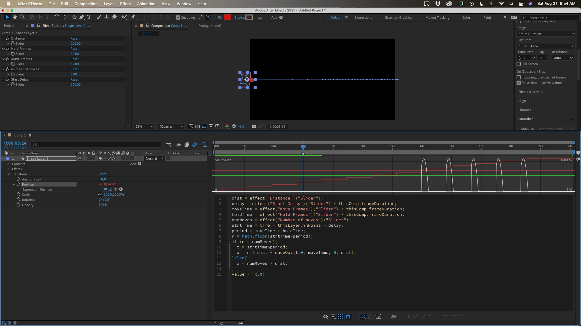

I am turning that into an animation preset and trying to fancy it up with a delay and also an overshoot and decay. If I throw in a delay slider and offset time by the delay and the layer in-point I'm getting jumps in position. I can't figure out how to prevent moves before the delay. Any clues would be appreciated. Here's my expression and a screenshot with a timeline marker at the layer inPoint.
dist = effect("Distance")("Slider");
delay = effect("Start Delay")("Slider") * thisComp.frameDuration;
moveTime = effect("Move Frames")("Slider") * thisComp.frameDuration;
holdTime = effect("Hold Frames")("Slider") * thisComp.frameDuration;
numMoves = effect("Number of moves")("Slider");
strtTime = time - thisLayer.inPoint - delay;
period = moveTime + holdTime;
n = Math.floor(strtTime/period);
if (n < numMoves){
  t = strtTime%period;
  x = n * dist + easeOut(t,0, moveTime, 0, dist);
}else{
  x = numMoves * dist;
value + [x,0]
I can't figure out how to prevent movement before the delay.
Try changing this:
to this:
strtTime = Math.max(time - thisLayer.inPoint - delay,0);

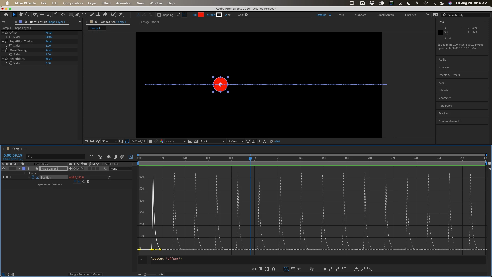

By far the easiest solution would be to set a starting keyframe, then move down the timeline to where you want the animation to start and set a second keyframe with the same values, then move down the timeline to where you want the layer to move and move the layer. You now have two keyframes, the first and second are identical and the third is where the layer will move the first time.
Now add a simple loopOut("offset") expression. You can then easily control the easing with a value graph and get s timeline that looks like this:
To stop the animation at a certain point pre-compose, add time remapping, set a keyframe where you want the animation to stop, then delete the last time remapping keyframe.
If you want an expression with sliders you'll have to set up an accumulator. I don't have time to work that out right now. Maybe Dan Ebberts will step in. He could write it without opening AE.
if (n < numMoves){
}else{
value + [x,0]
