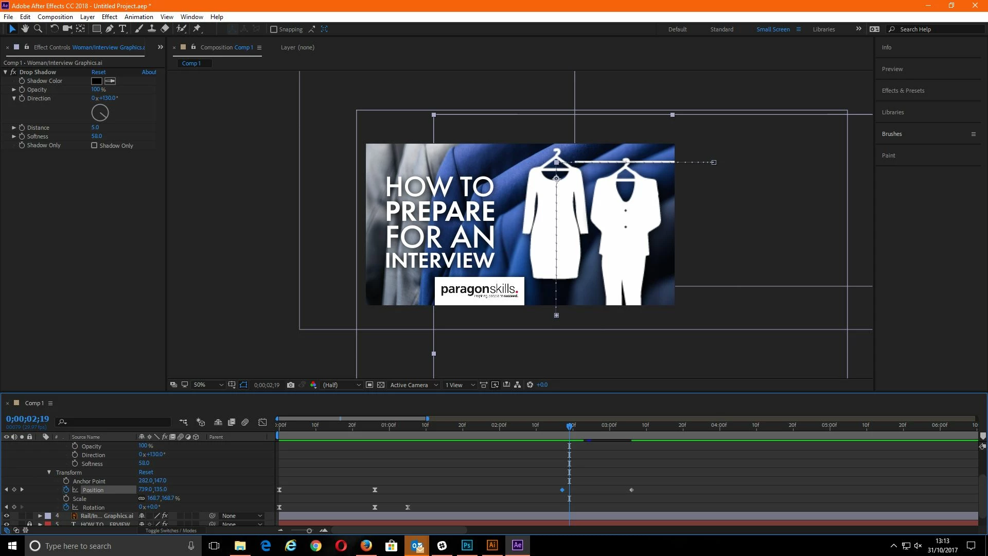

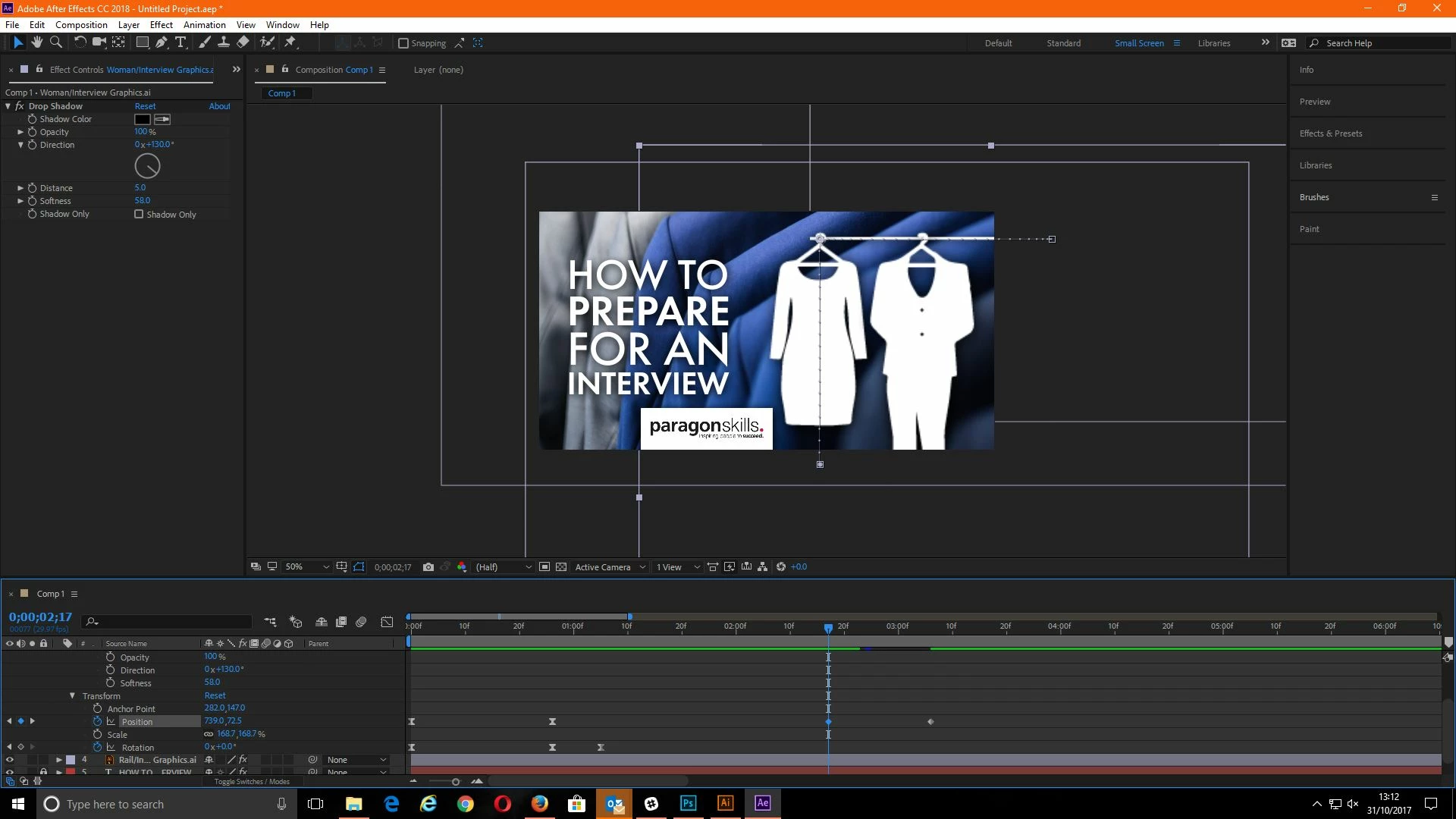

Oct 31, 2017 1:16 PM UTC
Here are the first three frames, at the moment it's just meant to fall off, i'll add the rotation and everything in later, but as you can see in the second frame after the first position keyframe it jumps up. After that, it skips back down to where it should be.
