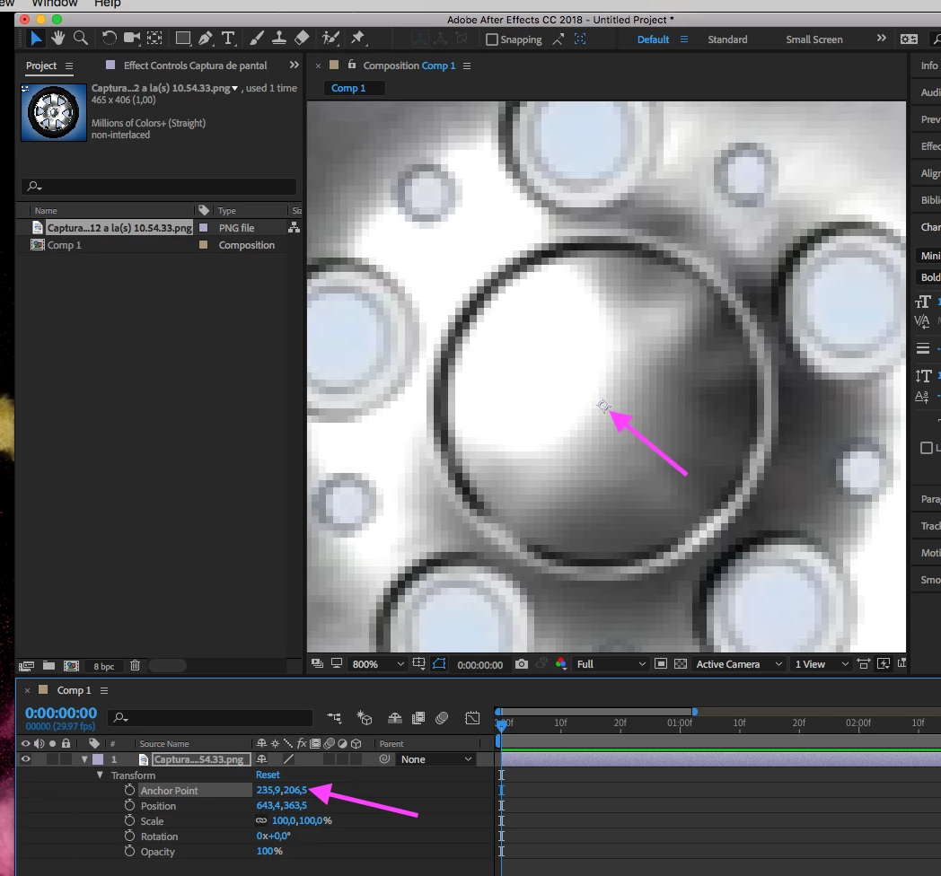

    Set the Anchor Point at the center of the wheel, exactly in the middle, try the best.

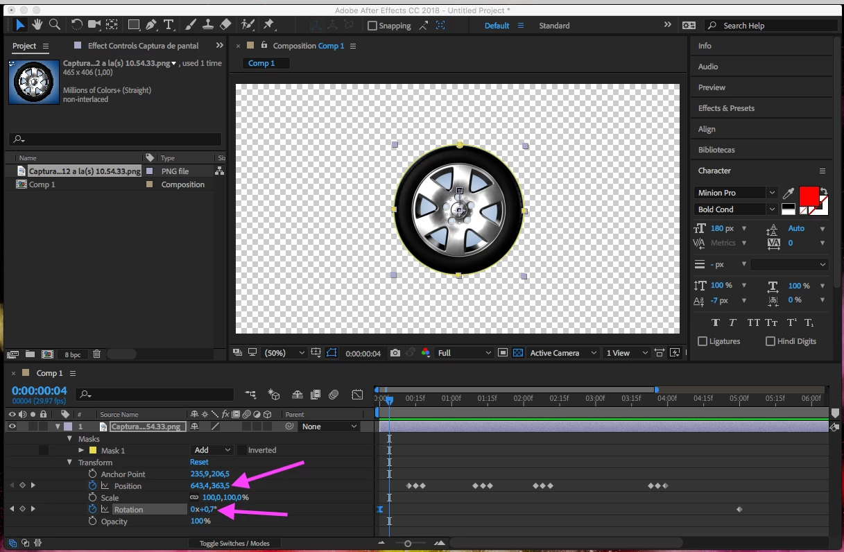

    Make the motion of the Rotation and the Position of the wheel.

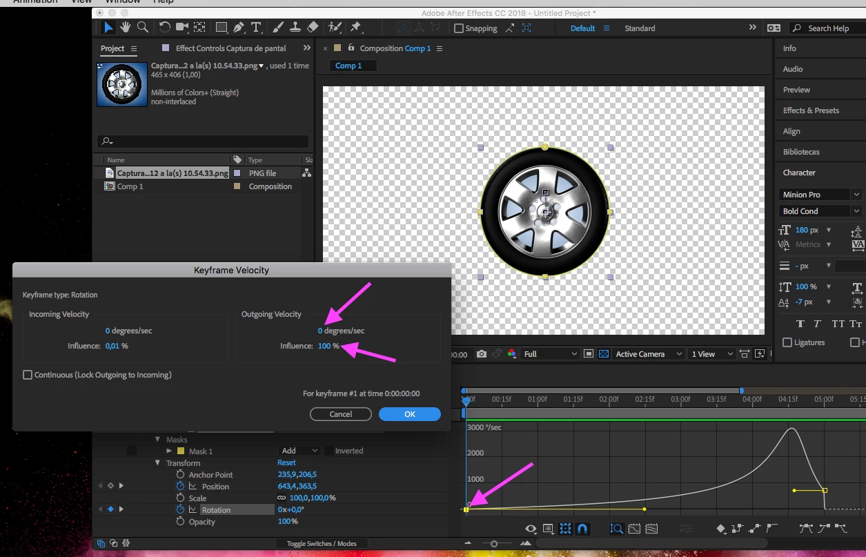

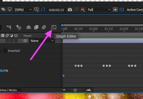

    Then, go to the Graph Editor clicking in the button that I show you in screenshot.
    Double clic in the little yellow button (see screenshot below) and set the parameters that you can see in the same screenshot to modify the velocity and the influence.
    With this instructions you can go on.
    I hope this helps you.
