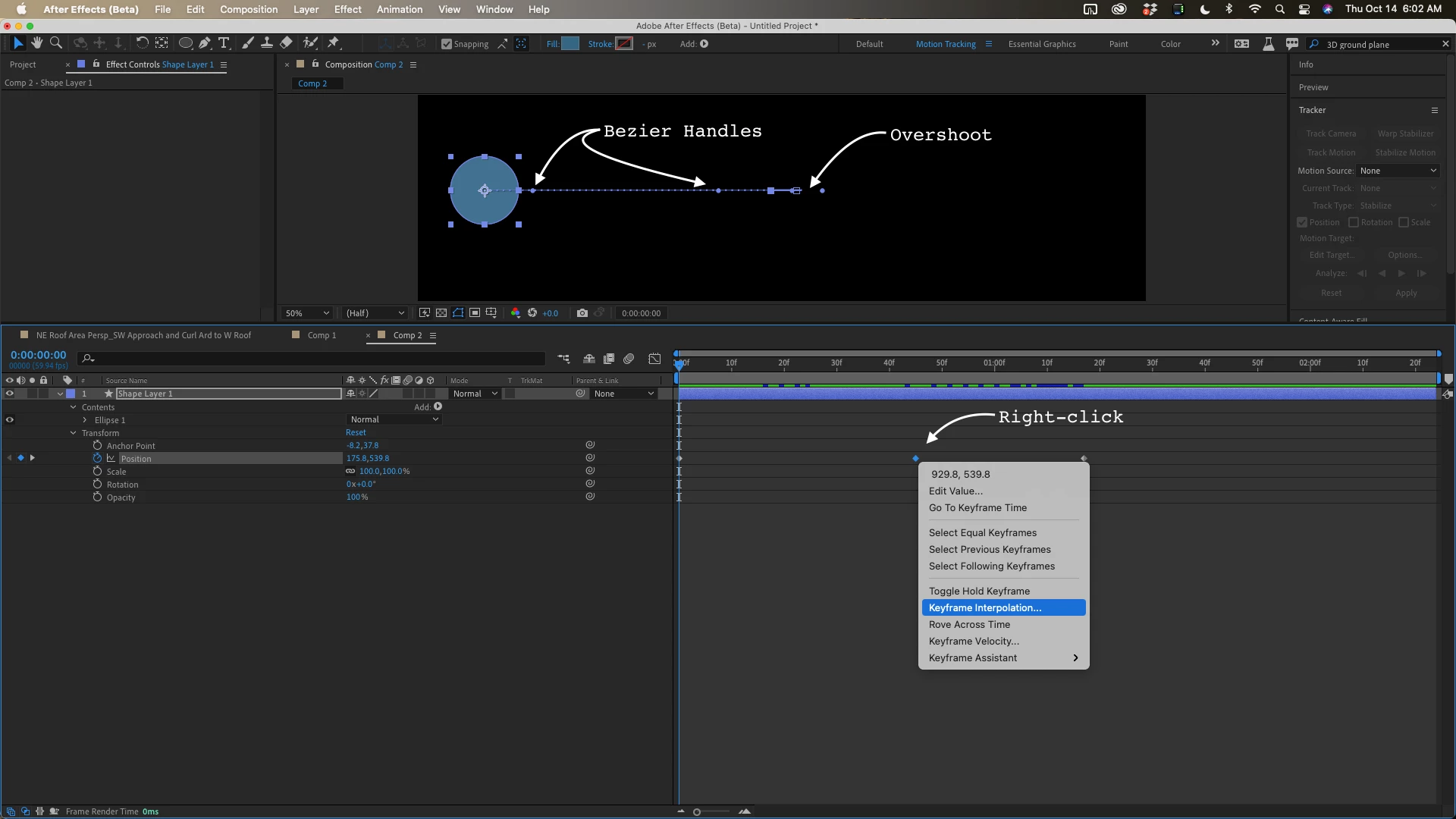

Hello. I'm a beginner and I'm wondering about an effect in my animation. I did a simple linear keyframe animation wit 3 keyframes with a fast moving from 1 to 2 and a slower moving from 2 to 3. Now my object reaches the end point of the moving a few frames before keyframe 3 and than moves back a little distance.
How does that work without a keyframe at that point? And how can I prevent my object from moving back? just go from a to b in a straight line?
October 14, 2021

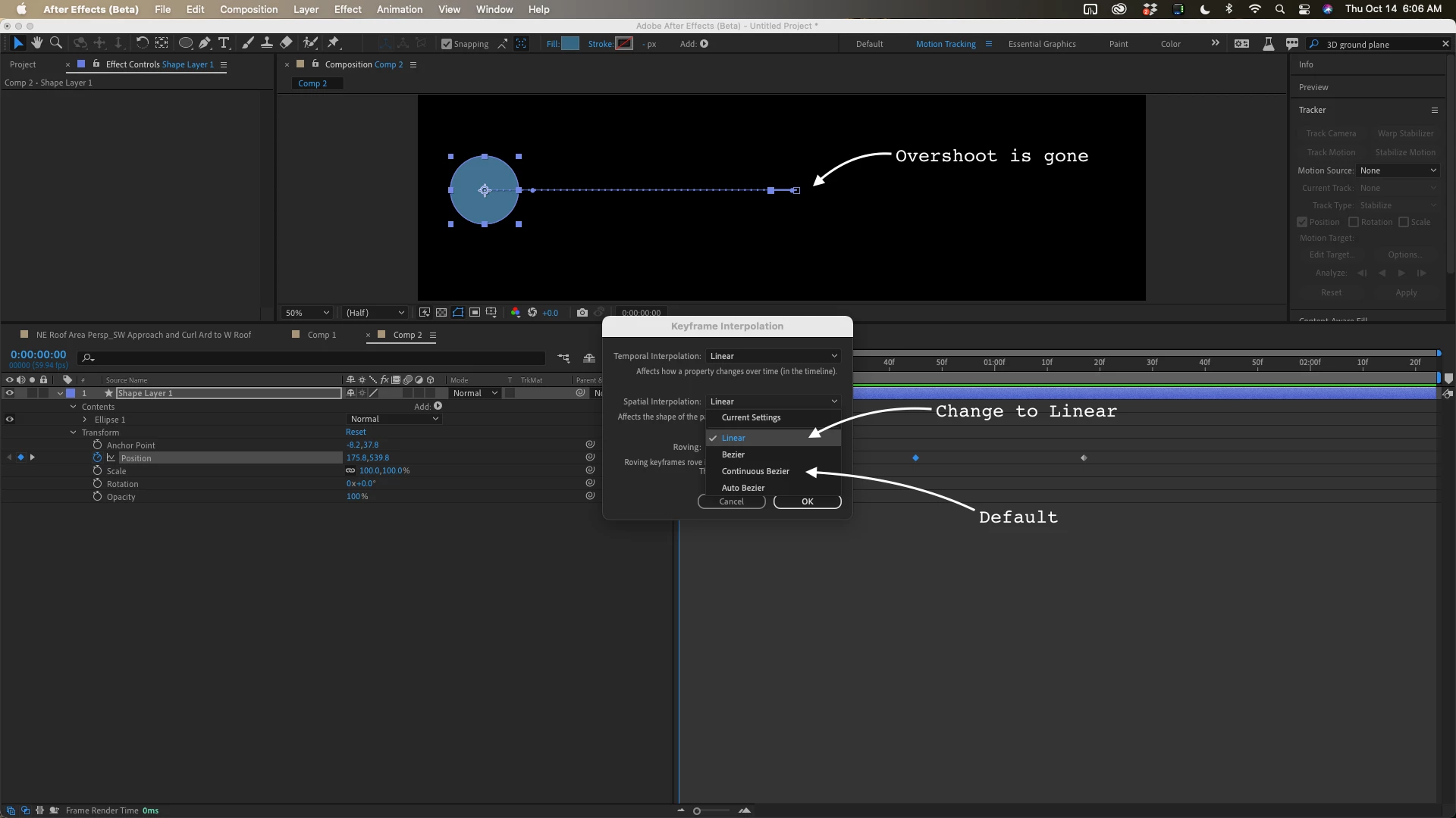

Select the middle keyframe, right-click, open Keyframe Interpolation:
Change Spatial Interpolation to Linear:
Auto Bezier spatial interpolation almost always produces a more natural movement but it can cause overshoot problems. The trickiest part of solving the problem is figuring which keyframe to change. It is usually the one before the overshoot.
