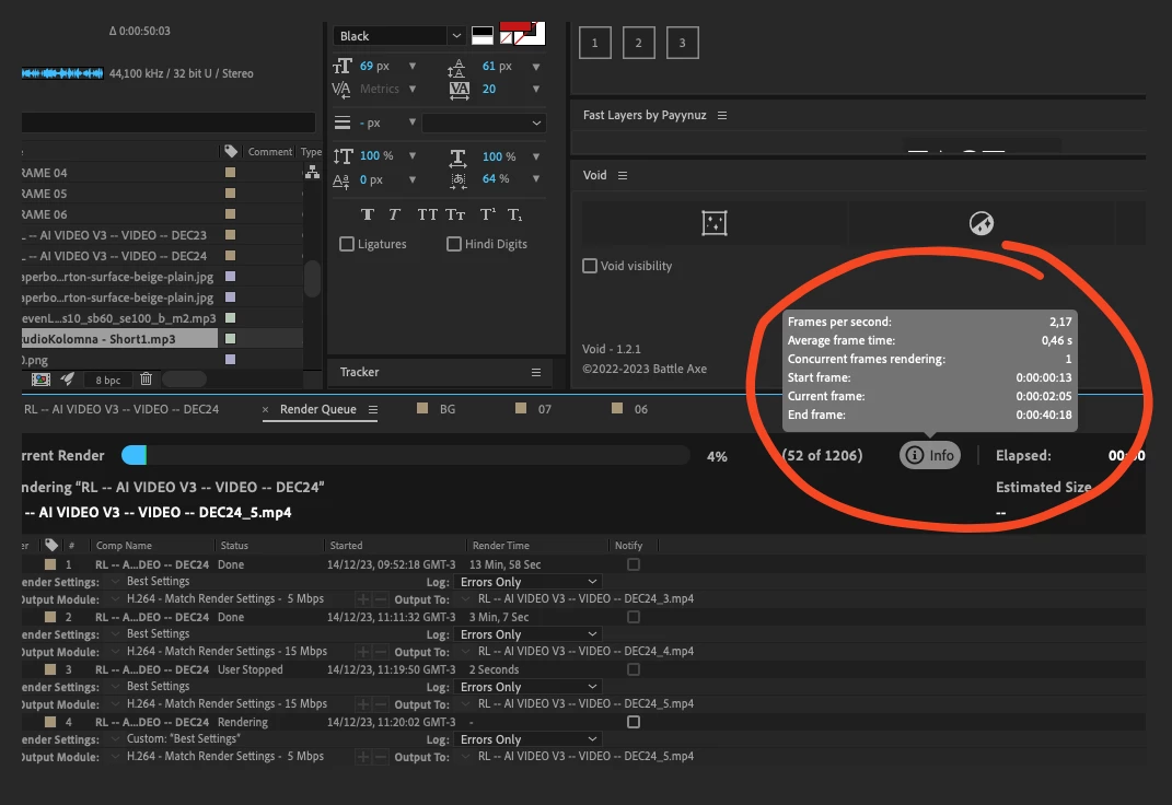

Multiframe rendering won't work when exporting
I  know when you have multi-frame rendering allowed there should also be a green bar indicating the frames that are rendering at the same time, But it's not working for me, as you can see it also says that there is only one frame rendering at a time. It appears to work on preview, info pannel says 2-5 frames are rendering at the same time, but not when exporting, am I doing something wrong?

You're probably not doing anything wrong. MFR will adjust the concurrent frames based on the composition being rendered and the performance of your system. As the comp is being rendered, MFR will look at how long frames are taking and if it can go faster by having more or less concurrent frames. The set of effects you have applied can also affect the concurrency - if they do or don't support MFR, if they require access to processed frames, etc.
In terms of preview vs. export, are you previewing at the same resolution as the export?
