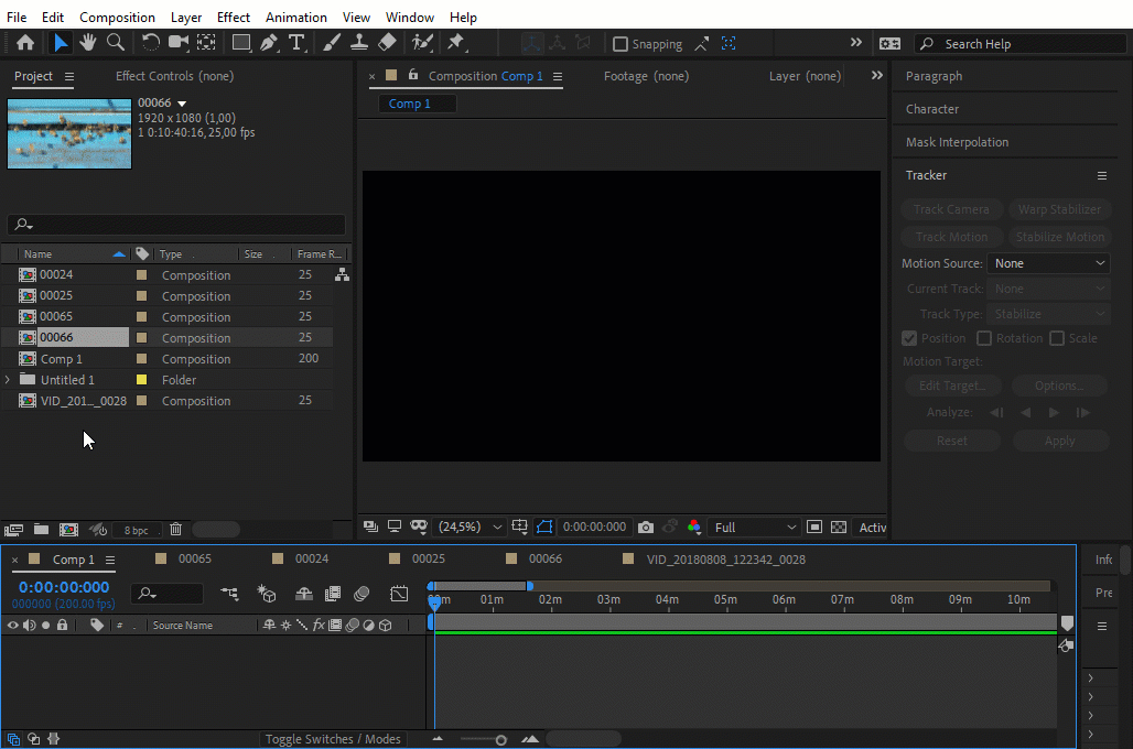

I'm new with AE and I couldnt find anything about this online so Its probably something thats easy and im just not understanding.  I'm doing a project that I made multiple comps for.  I was under the impression that you could get the comps to play 1 after another in a single video file yet i cant figure this out.  How do you actually accomplish this?

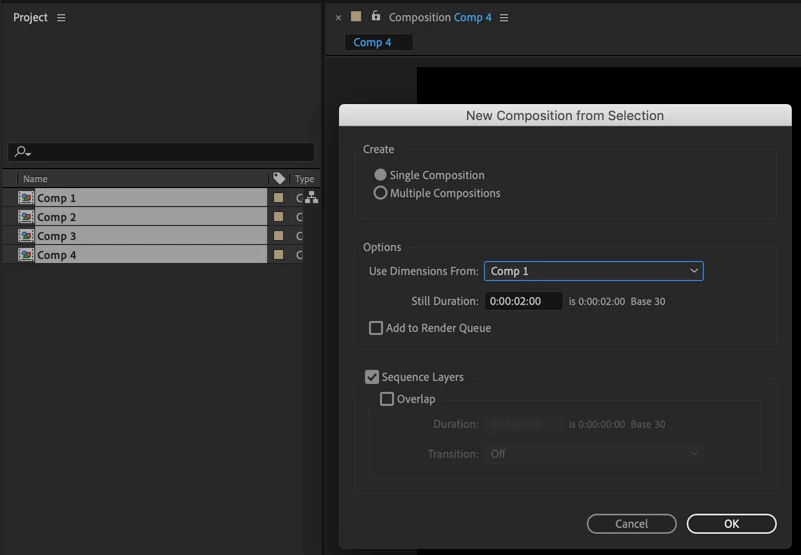

    You can also select a bunch of compositions in the Project Panel then press Alt/Option + \ or select File>New Composition From Selection, or right-click or drag all comps to the Create New Comp icon at the bottom of the Project panel. You will be given the option to create one comp from all selected comps or footage. If the comps have different dimensions you can choose one of them to be the master. You can also choose to overlap and create a transition between comps.

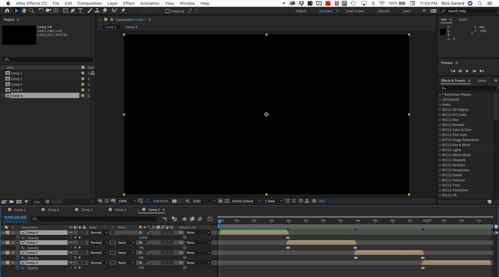

    One more important thing to remember when using this efficient technique. If you hold down the Ctrl/Cmnd key while you select you can arrange the comps in any order you like. This is what happened when I selected layer 4, 1, 2, 3 and set overlap to 15 frames and cross dissolve between layers.

    Just make one main/final composition and just put all of your compositions one after another on AE timeline and export. Here quick example:
