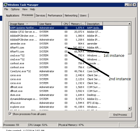

its working perfectly when i update a single template at a time but when multiple users come at the same time then they need multiple instances of after effects

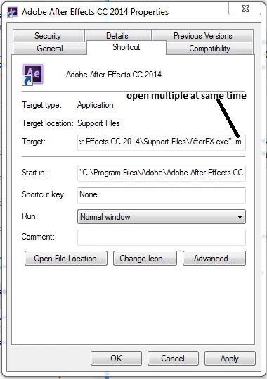

so i open multiple instances of after effects by using "-m" with after effects shortcut
after looking at windows task manager there are both instances but the problem is
only once instance continue and the second one stop, after completion of first instance the second one still in pause status
i need 2,3 4 or whatever instances to work parallel without pause/stop

That's a totally unsupported configuration in the first place and you will be hard pressed to find anyone who can help you. Presumably you need to create separate shortcuts/ batch files and run them in separate instance contexts. AE itself will always detect running instances and re-use them.

You mean to create separate shortcut for each instance to work independently
so before i run the script to change my AE template, i have to create a new AE shortcut which will open a new independent instance of AE ?
