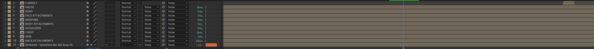

So the way I did it was, the main comp has this:
Each layer is one equipment slot comp that keeps changing.
Here's one of those comps:
So there's 4 possible items, and they loop, showing only one item at a time.
In the main comp, there's one "correct" layer which has the desired image show for 10 frames, that's where the user has to pause it.
Done 🙂
