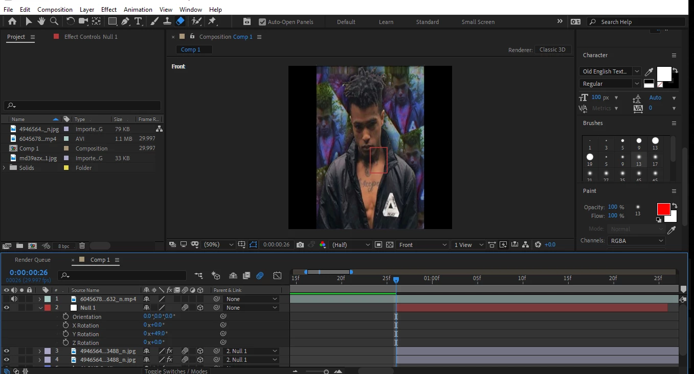

My 3d layer acts weird when it rotates or scale is changed. (Need help)
(ADOBE AFTER EFFECTS CC 2019) When ever I turn on 3d layer its normal but when i change any of the X or Y positions or rotation it looks like it would be stretching then closing in. When I press space to preview it, it shows how it is supposed to look like.
1st one glitched.
2nd one the right way its supposed to be.
( PLEASE HELP )

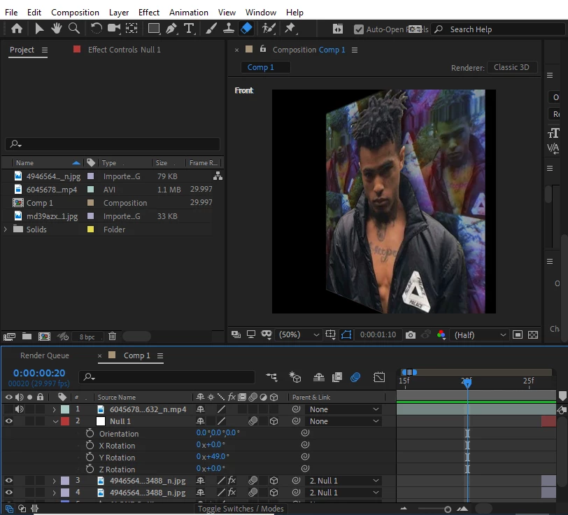

    You miss the camera view setting.
    In your comp-panel, the view is set to front:
    This is a view for creation process. When you preview render or final render, it renders the camera-view, which is whatever you set up, or some default when there is no camera-layer in comp.
    To see what the final outcome will look like, just change front-view to - I think - active camera. Play around with the views to gt a feeling for it.

    Mo Moolla , There is no difference in the perspective between a 2 node camera and a 1 node camera. The only difference is in how you point the camera. The reason that the OP's view looks weird is that it is an isometric view - there is no perspective.
    Any view other than Active Camera is an isometric view. NO perspective. Perspective is controlled by camera position, framing by focal length. It's that way in the real world, it's that way in AE's virtual camera. If your view does not say Active Camera it will not render. If your view says Camera 1 or any other camera in the comp, only the top camera in the timeline will be chosen as the active camera. If you want the other cameras to render you have to move them to the top of the timeline. If. you want to cut between cameras you have to set in and out points for the camera layers.
    All of this is explained in the User Guide.
