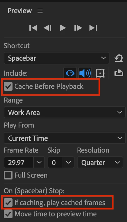

    try to cache your preview before play

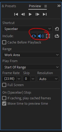

    Make sure you have the Audio button checked in the preview window
    If it is and you pull up levels on your media (select layer > press "L" > expand "Waveform"), then the problem has to be with your audio hardware. Restart the app, restart the computer, try different audio settings, update audio hardware drivers, and all that.
