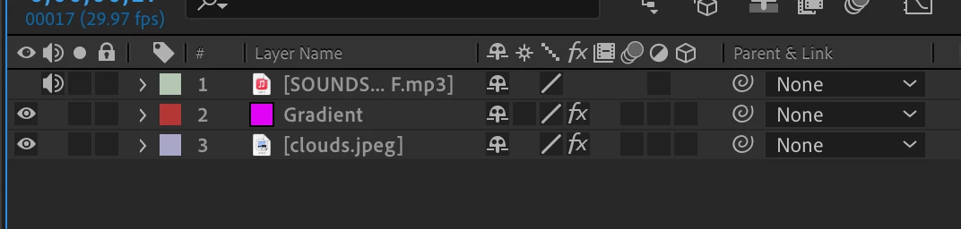

Is your audio toggled as a Guide Layer? There will be an icon to the left of the layer name with two sets cyan lines making a tic tac toe-like grid: https://www.premiumbeat.com/blog/10-time-saving-tips-in-after-effects/#:~:text=To%20make%20any%20layer%20a,now%20it%20won't%20render.
Guide layers don't export by default, but they will play back in the composition they're placed in.
Is this what's happening?

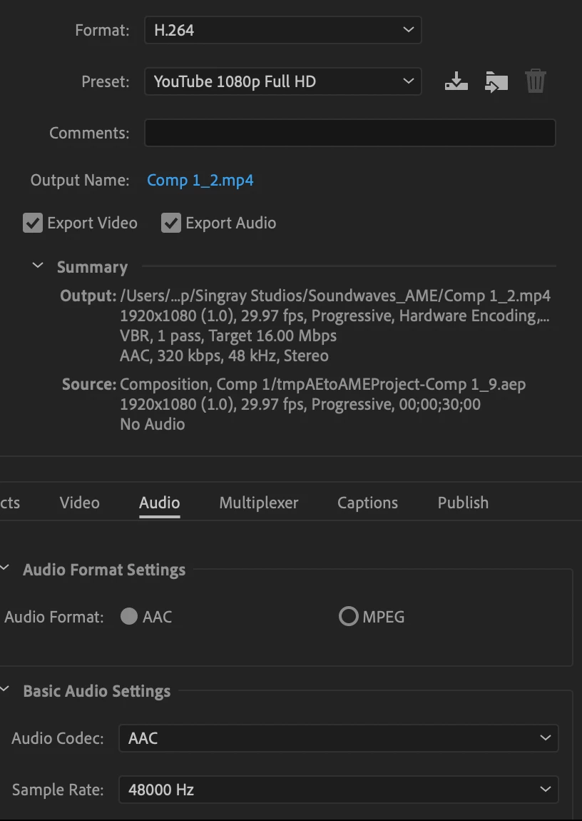

Well, as per your screenshots it says there is no audio. Any chance you have accidentally muted the layer or something like that?

July 12, 2021
These are my settings. It looks like the audio isn't being carried over into media encoder.

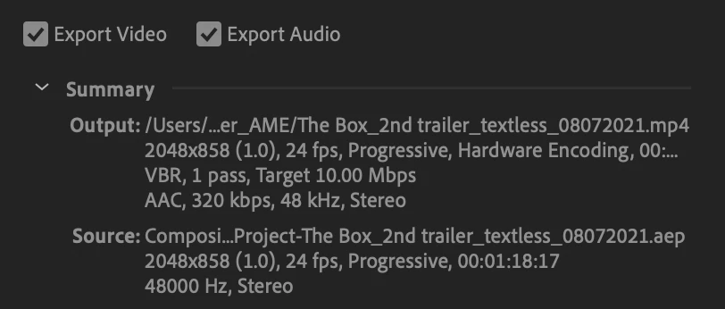

The first question, if you export directly from AE did you get a sound? and did you double-check if presets you use on AME have the export Audio activated

Did you fiddle with the presets in the Adobe Media encoder? What does your comp look like? The combination of things that you can do to your comp is almost unlimited, and so are the user errors you might make. Without workflow details and/or an embedded screenshot of the comp with the modified properties of the problem layer revealed (select and press 'uu') it is going to be difficult to find problems in your comp. Without render settings details and a screenshot showing those, it's also going to be difficult.
