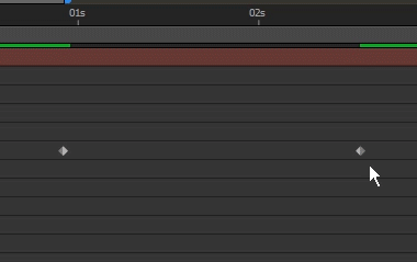

    select a keyframe and drag it close to the other keyframe, that's how you will make whatever value you have move faster from one point to the next.

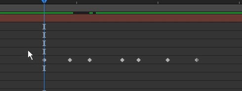

    if you have a couple (at least three or more) you can select them all by clicking and dragging a rectangle around them and then alt+click and drag the first or the last and you will contract or expand them together
