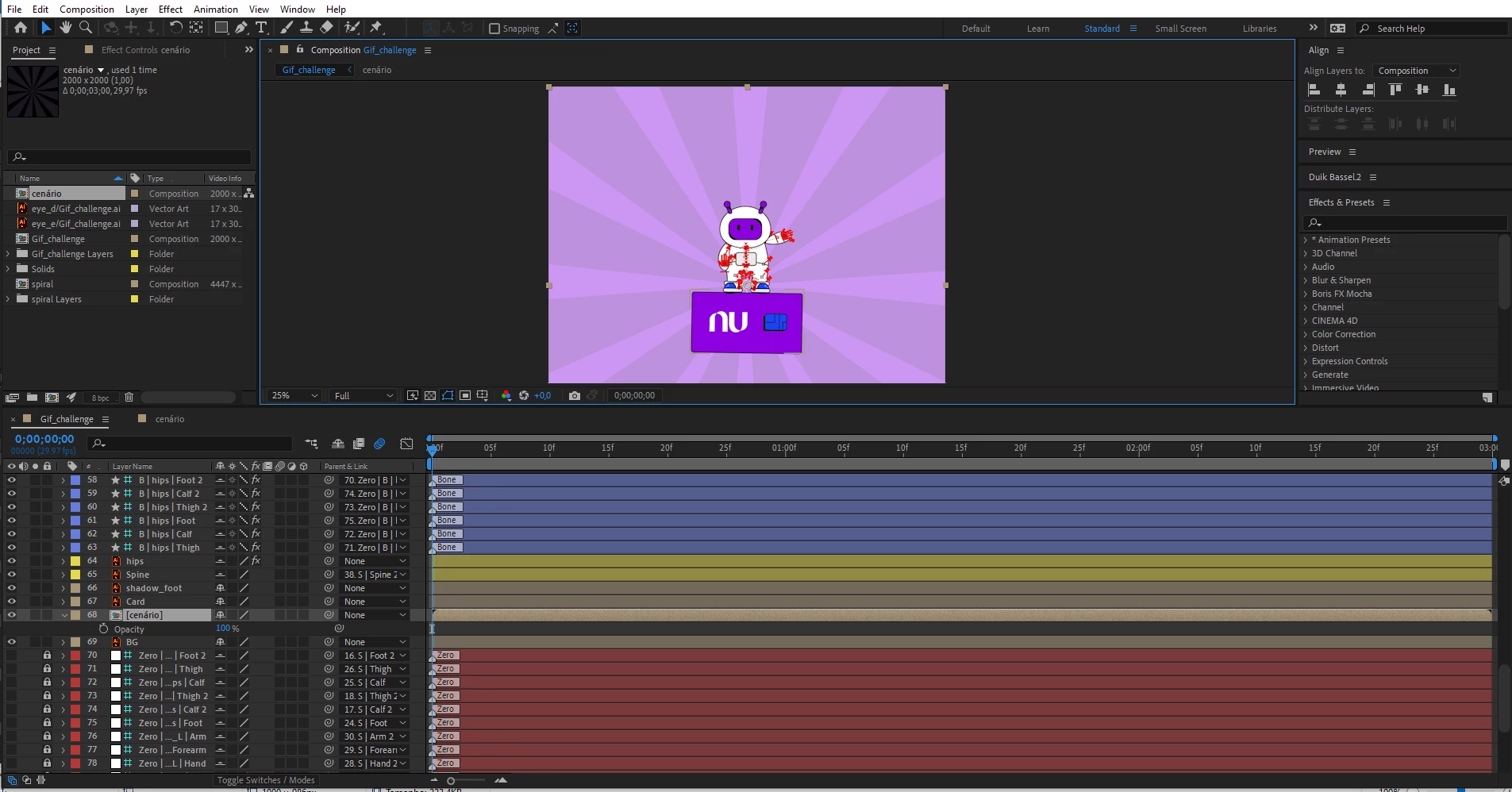

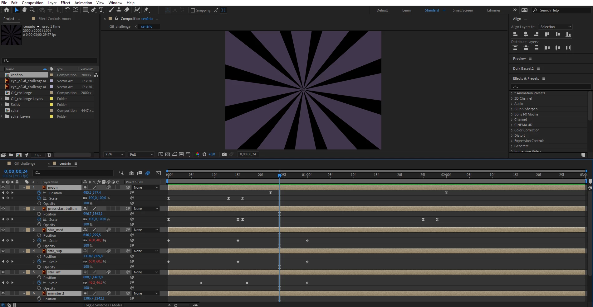

My first print are from the pre compose that i create for animate the scenario.
The components dont show up and they are with the visible eye, full opacity and they are not guide items.
Only one layer appers, it is the "spiral" layer
Now, this is my main composion and as you can see the "scenario" layer are visible and full opacity.
And the middle I realize that the reflexion layer dont show up anymore either.
The only layer that appers is the spiral one.
When I was animating, the layers are normal, I dont know what happened. It was after I render with media encorder 😕😕
Please, help me 😞

Do you have anything changed from the defaults in your Modes panel? Any Blending Modes or track mattes that might be affecting visibility?

Is it possible that you have the solo switch turned on for a layer?

Hi, Szalam 🙂
Thank you for the reply.
I havent, I checked all layers 😞 In this project I just use the shy mode in rig layers.
But, in this print, the shy mode are off 😕😕
