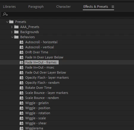

Roland Kahlenberg
June 28, 2022
AE has a pre-installed Animation Preset (ffx) that auto-fades based on the layer's in-out points. You can specify a duration for the fades - see image below
There's also the Animation Preset - Opacity Flash - layer markers. This is also useful.
HTH

vasulden
vasuldenAuthor
June 28, 2022
many thanks @Roland Kahlenberg !
have tried that thing already. But I would like to keep the one layer, with several keyframes and make them animate every time when a new keyframe appears per time. But didn't realize the right parameter to let the expression know which is a range of Start/End points in the term of keyframes, but not the whole layer

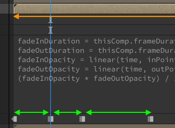

vasulden
vasuldenAuthor
June 28, 2022
those hold keys are doesn't belong to Opacity. it might be something random thing, even out of this Comp, even not a slider 🙂
but maybe I'll define my obsession, have tried to make that range of inputted keys to use sort of linear expression as above... 😞
