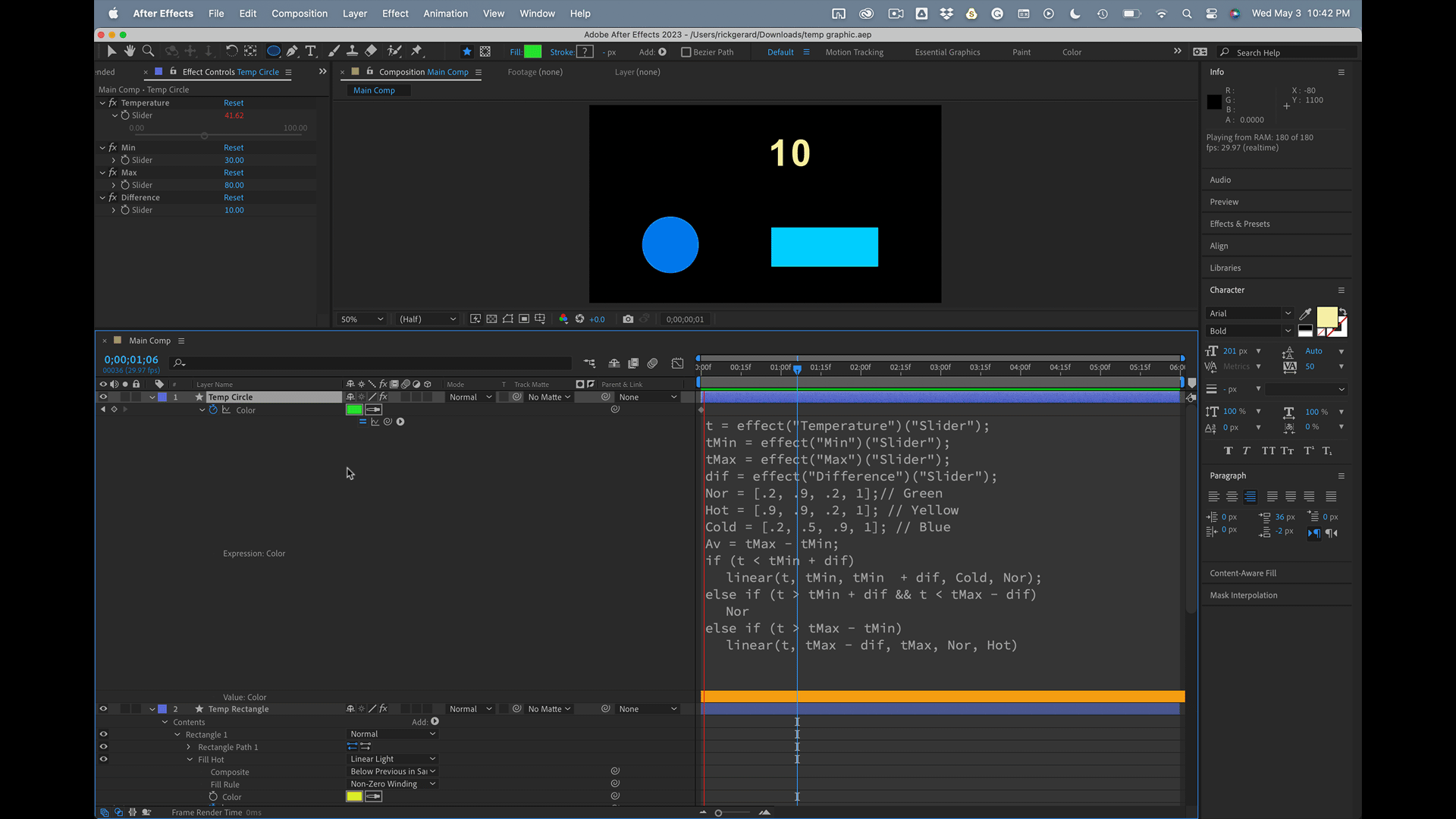

You could use the same approach to directly control the color of a fill by figuring out the RGB values you want for the color changes and replacing the 0 and 100 with the starting and ending RGB colors. That would require only one shape layer and an expression for color that looked something like this:
t = effect("Temperature")("Slider");
tMin = effect("Min")("Slider");
tMax = effect("Max")("Slider");
dif = effect("Difference")("Slider");
Nor = [.2, .9, .2, 1];// Green
Hot = [.9, .9, .2, 1]; // Yellow
Cold = [.2, .5, .9, 1]; // Blue
Av = tMax - tMin;
if (t < tMin + dif)
	linear(t, tMin, tMin  + dif, Cold, Nor);
else if (t > tMin + dif && t < tMax - dif)
	Nor
else if (t > tMax - tMin)
	linear(t, tMax - dif, tMax, Nor, Hot)
Color values are always 0 to 1 for R, G, B, and A unless you use a converter method in the expression. I usually just use the float values and have my Info panel always set to decimal (32-bit), so the color picker gives you the decimal values for RGB. You'll end up with something like this:
