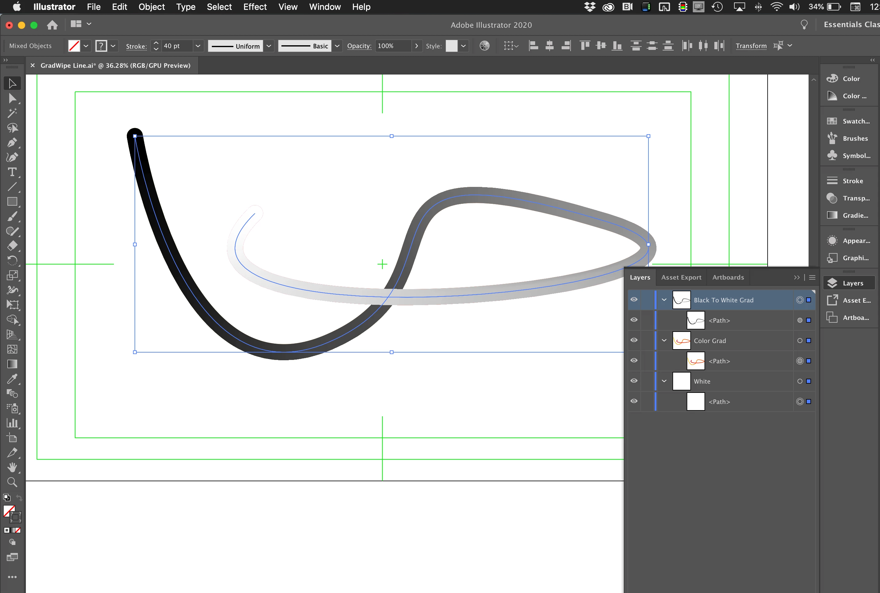

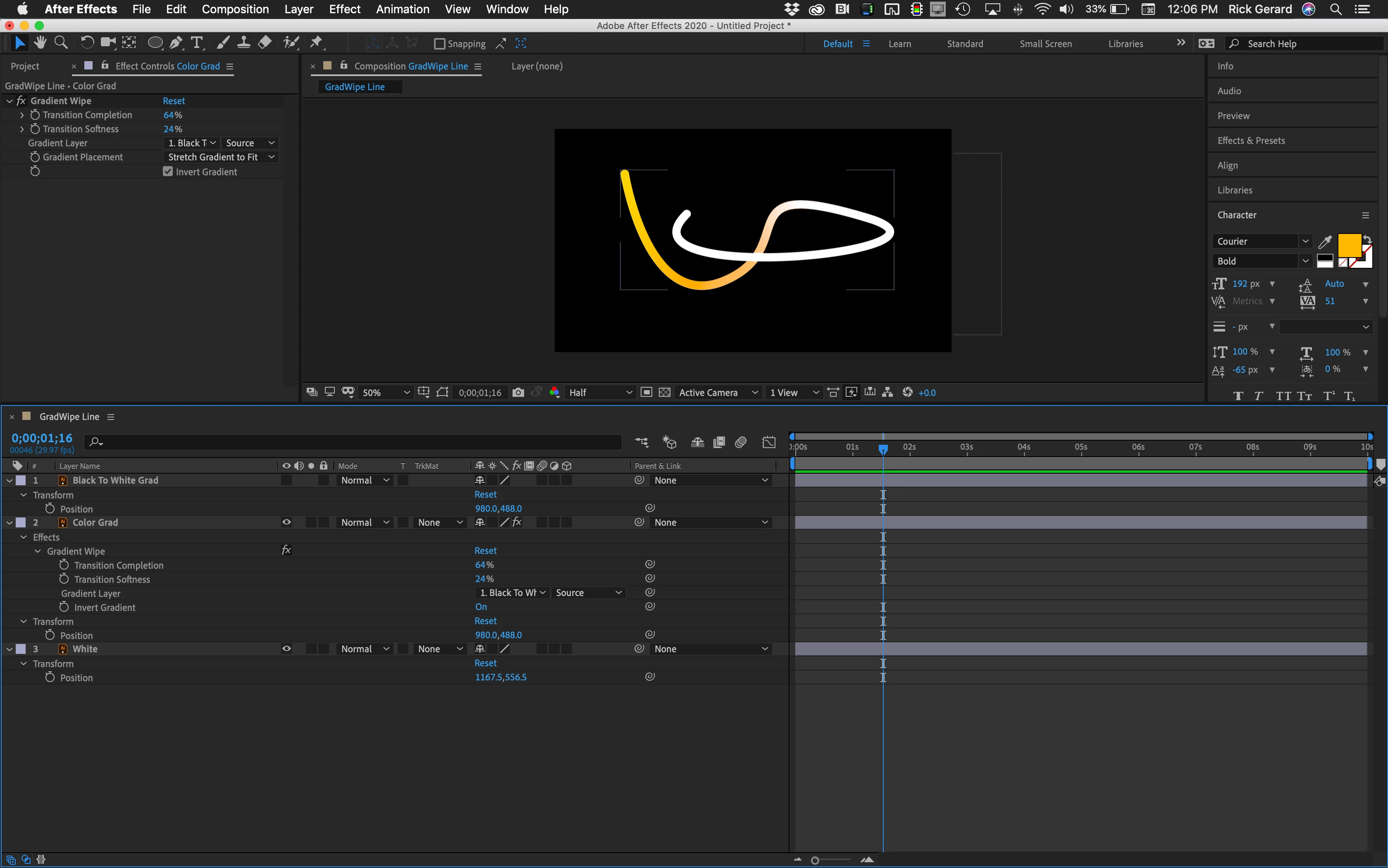

You can make a gradient along a path in Illustrator. If you start with your white path on the bottom layer, duplicate the layer and change the stroke to gradient along a path and create your color gradient, then duplicate the layer again and change the gradient along a path from black to white you can import the whole thing into After Effects as a composition then set the black to white layer as the source for a Gradient Wipe applied to the colored gradient layer and animate the reveal:
If you carefully examine the screenshots you'll see everything that I did to reveal the gold to red gradient path on layer 2.
This is an easier way to get a soft edge reveal than using trim paths.  If you want to stick with trim paths you'll have to add Trim Paths to a wider copy of the line you want to reveal above it, add a blur, then use that copy as a track matte for the layer below.
The key to making this kind of a transition easy to animate in Illustrator is creating the proper layered illustration in AI before you even start anything in AE.
