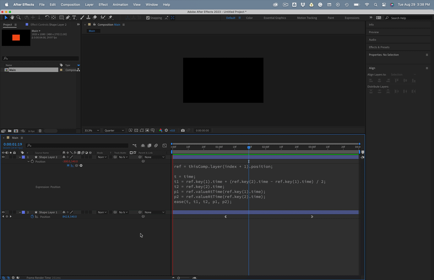

If the first layer that moves is below the second layer, I would use this expression for position on the top layer:
ref = thisComp.layer(index + 1).position;
t = time;
t1 = ref.key(1).time + (ref.key(2).time - ref.key(1).time) / 2;
t2 = ref.key(2).time;
p1 = ref.valueAtTime(ref.key(1).time);
p2 = ref.valueAtTime(ref.key(2).time);
ease(t, t1, t2, p1, p2);
You could also use an ease or easeIn interpolation on the last line.
The expression looks at the animated layer, determines the time of the keyframes, creates a starting time (t1) that is halfway between the first and second keyframes, and then moves the second (top layer) from the first layer's original position to the original layer's second position. You could use this expression for any property just by changing the property in the first line from position to rotation or anything else you want to copy.
Mr.Dubb
Mr.DubbAuthor
August 29, 2023
thank you so much! I was in the ballpark with my attempts but this is very clear to where my mistakes were. I wasnt properly defining my keyframes which then messed up me referencing their valueattime and those combined were returning errors on my linear command. I started to really get into the weeds with this one when i knew it couldnt be too complicated. still a bit green to java so this is a huge help.
