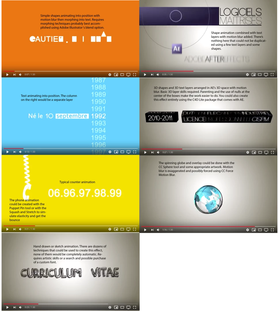

    There are techniques for the sections you selected, not names. They are all pretty basic. Using After Effects is pretty complicated and requires a lot of time to learn to use and understand. Here's a breakdown of what techniques have been used to create each section:
    The thing that makes those sections work fairly well is the timing and the application of the basic principals of animation described in the book The Illusion of Life: Disney Animation: Ollie Johnston, Frank Thomas. It takes quite a bit of practice to learn those techniques.
    I assume that you want to build an animated resume for yourself as an Economist, not a motion graphics professional. If you take the time to dig through the documentation for After Effects and find good tutorials on a few of the techniques I talked about it could easily take you 100 hours to complete a 2-minute resume video. If you took a look at a few paid text animation templates you could probably cut that down to about 10 hours of fiddling with After Effects to figure out how it works enough to put your own text in a template. If you decide to just search for tutorials it is incredibly important that you vet your trainers. More than half the tutorials that are currently being put up on YouTube and Vimeo are by amateurs that don't really know what they are doing. Many of the workflows and techniques are incredibly inefficient and many of them just don't work. Make sure you find out who posted the video and they know what they are talking about.
