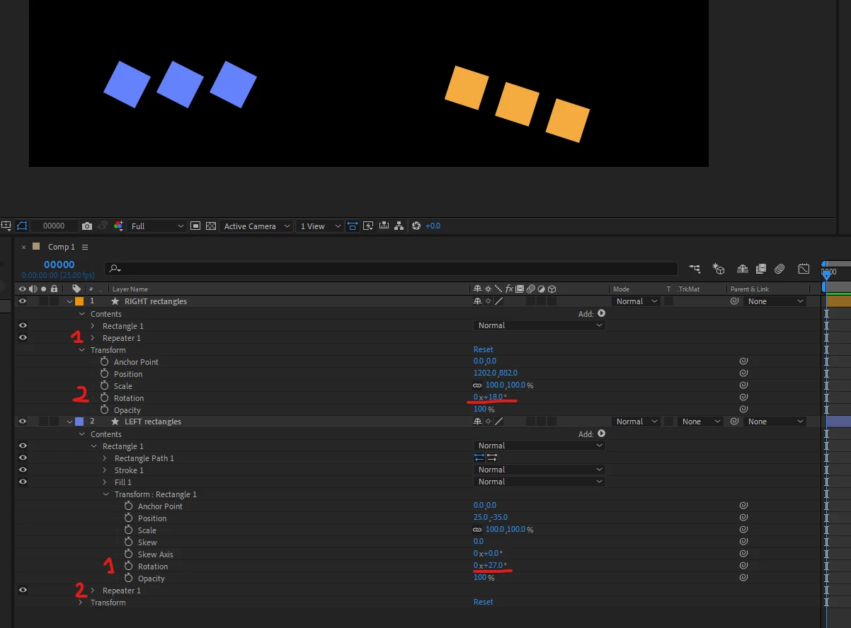

Hello, I am very new here on the forums and I am just recently gotten back into After Effects. I'm trying to make use of the repeater tool by rotating the squares into a diamond shape like this
But whenever I attempt to rotate the object it follows along like this
What should I do?
Correct answer dbDavideBoscolo
No, you are doing it the wrong way.
You are applying the repeater first and then you rotate the layer.
What I did was to rotate the rectangle first and then apply the repeater.
The order is important.

October 30, 2018
Try to rotate the rectangle only not the whole layer.

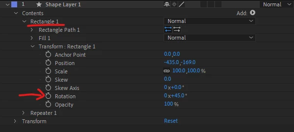

Efren_580Author
November 6, 2018
I tried that but they all follow along the same square.
dbDavideBoscolo
dbDavideBoscoloCorrect answer
November 6, 2018
