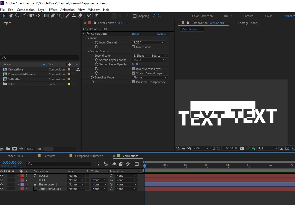

I would probably use set matte for this and duplicates of the text and forsake some elegance for more precise color control, but for calculation effect works fine for this also:
here's the project file for you to try it out:
inverttext.aep - Google Drive

Hey thanks a lot for the solution and the project file!
The Calculation works perfect for me.

If I understand you, I think the only thing you need to do is to change the transfer mode of your test layer to Difference. Check the attached image.
