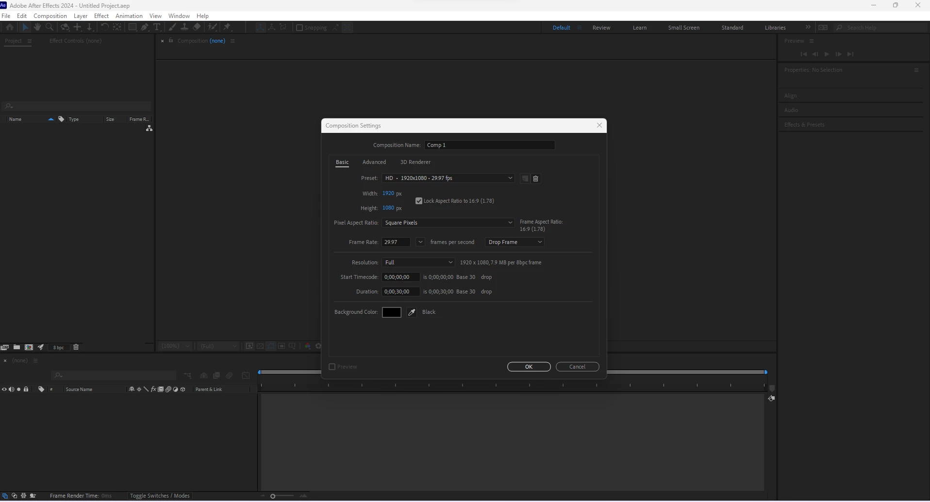

'New Composition' hanging when I click OK
I tried using a previous version of After Effects, and then reinstalling the latest version 24.2.1. It doesn't work in either.
I can create a 'New Composition from Footage', but not from 'New Composition' which is what I want.
I click OK and nothing happens. Clicking Cancel doesn't do anything either. I have to use X in the top right corner to get rid of the create new composition window.

Mar 6, 2024 5:41 PM UTC
Check and make sure that the Composition Settings/3D Renderer is set to Classic 3D.
You should also check your Preferences and possibly reset them.
Mar 6, 2024 10:03 PM UTC
Hi Rick.
Yes, 3D Renderer is set to Classic 3D
l've also checked through my preferences more than once but can't see anything in there that would cause this issue. I reset them twice but nothing solved.
