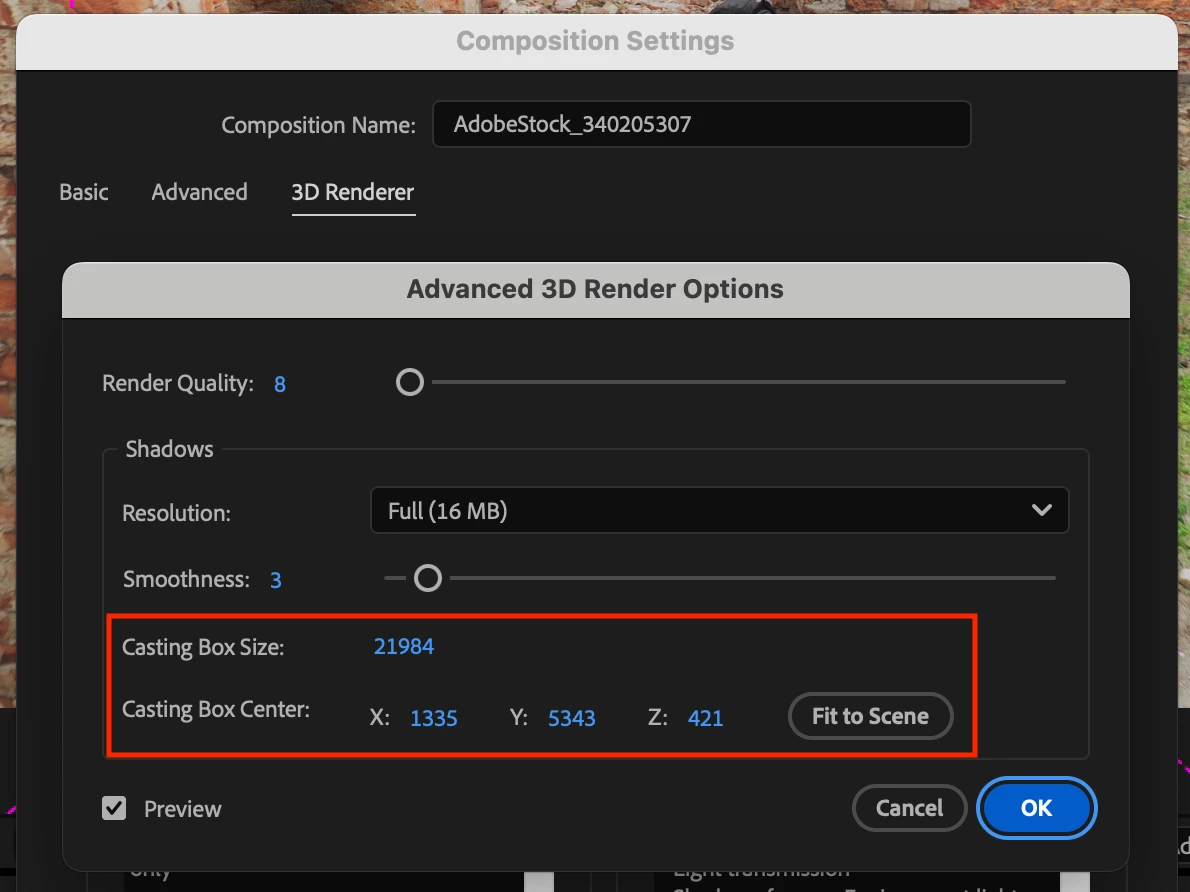

I had this same problem with not being able to see shadows for 3d objects on my shadow catcher (with all light/shadow settings correctly set, and shadow catcher and lights oriented correctly as suggested in numerous forum posts)
I was able to get my shadows to show for an Advanced 3D comp - for Environmental Lights only- by going into Composition Settings, Options for Advanced 3D, then selecting the 'Fit to Scene' button for Casting Box Size/Center.  This changed the values in those boxes and then my scene's shadows became visible.
Hope this helps someone else with the same issue.

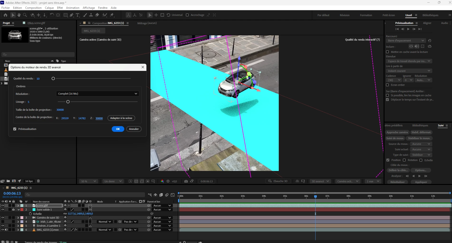

Hello, I have a problem with the casting box position, the value of the Z does not go beyond 30000 and it place the box like this when I click on Fit to Scene. I can't moove the box behond so I can't see the shadow of my car deeper into my scene, I do a lot of search but I have no answer to how fix this box problem.
ShiveringCactus
Apr 28, 2025 10:32 AM UTC
Can you make your shadow catcher a child of the 3D object, then set its position to 0,0,0 and then move it from there?

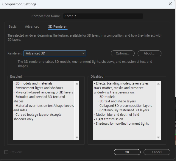

Open composition settings (Ctrl/Cmnd + K) and carefully read the descriptions in the 3D Renderer tab. Everything is explained there.
You will need to work around the limitations using a different workflow and maybe some pre-comps or wait for other features to be added to the different rendering engines. The rendering engines are also limited by GPU compatibility.

Thanks for your response. It appears ADVANCED 3D is not so advanced...
You either have extrusions or lights and shadows. This is ridiculous...
So if shadows for non environment lights are off, then the environment light can cast shadows in advanced 3d, right?

Yes, environmental lighs can cast shadows in advanced 3d.
